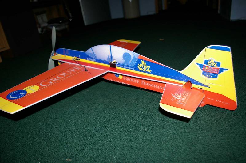

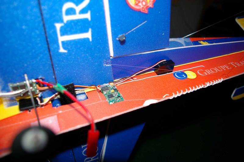

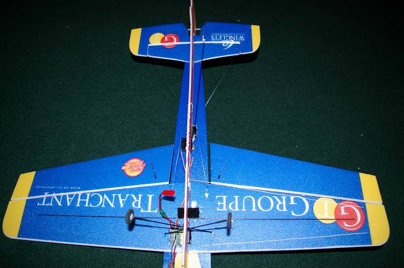

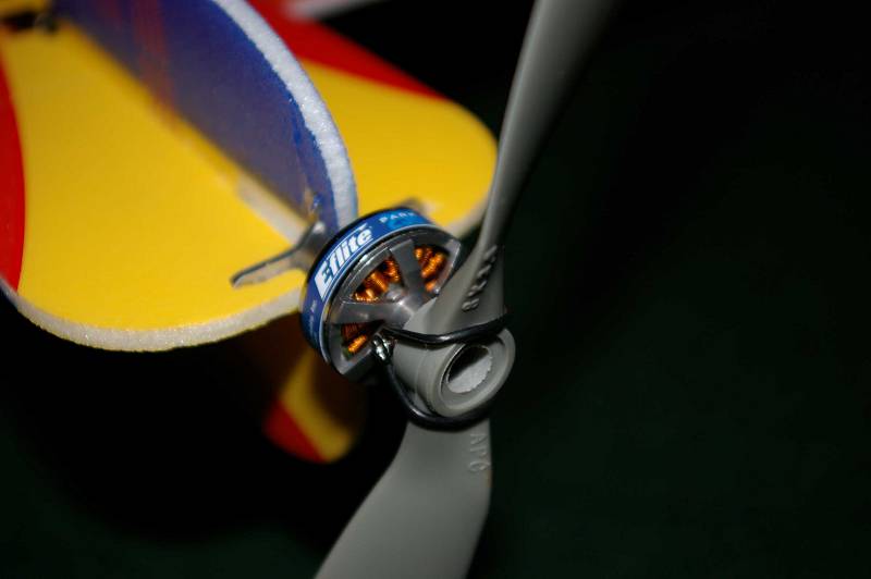

This thing is pretty cool i got mine down to 2.5oz with out battery i think ill be using a 2 cell 250. many mods to keep it this light, pull pull rudder, no plugs everything is soldered directly to rx and speed control. cases off on rx and speed control. others too! but the set up is, park 200 2000kv motor, blue berg rx, (3) 4.7g 18.0 in/oz servos, phoenix-10, battery tba. anybody have one?
