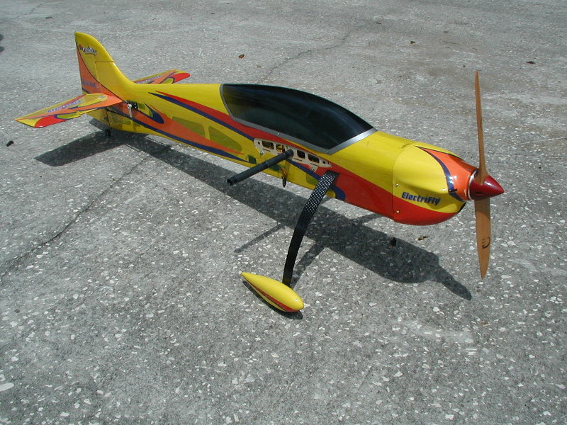

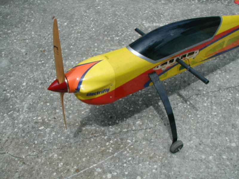

Here's the LG pics. 1/2" higher and each gear weighs 1.3oz. vs. 2.0 for the stock aluminum gear. Sweepback is gone hopefully curing the noseover tendencies in the grass. Also trying the Xoar 17 x 10 wooden e-prop too. Less flex and cavitation than APC's.
ORIGINAL: 3DownLow
ORIGINAL: drumbum
Thanks for your help, Ive been following the thread on the 3D glow forum. the stock gear will clear but it has a noseover issue due to the swept back look. some people are using U-can do gear..
Try Graphtechrc landing gear #239. Upgrade for the stock Reactor gear. The sweepback was taken out. I'll post pics of my Reactor with the new gear on as soon as it arrives. That should cure noseover problems.
