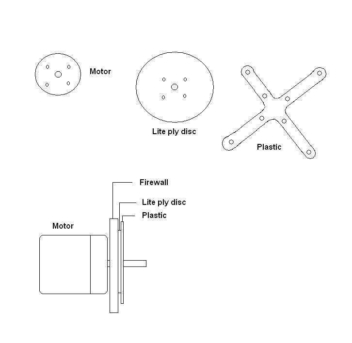

I have a few more questions about the motor install if you wouldn't mind.
I have never mounted an electric motor before and the instructions are not clear at all. In what sequence should I install the motor components. The motor came with a round lite ply disc, a plastic cross brace member and the motor.
I have attached a pic so that you can see what I'm talking about. Please excuse the poor scale and quality of the picture.
Thanks for any help you can provide.

First I see now you have a "Performance Aircraft". I mistakingly read "Precision Aerobatics" , my bad. Still I'll assume your kit has a motor- mount to attatch the motor to. Refering to your pic, the motor slips through the planes motor-mount like shown. But, don't use the disks or other parts from there just install the correct size and length bolts through the mount and into the 4 pre-taped holes in the motor housing. The Disk and cross are for mounting the motor to the firewall and running the motor backwards. Your motor came with two prop adapters, one goes on the shaft and one goes on the can. Use either but not both, and pick the way thats best for your plane.

Now, if I can just get the motor mounted. The X piece must be used, this much is obvious. The firewall already has some holes in it. These holes look like they are for cooling. I guess I will just have to drill some holes(4) for mounting the motor via X piece.
