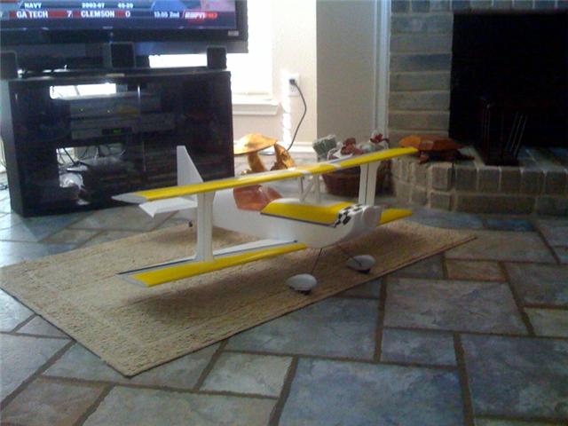

Hey gents,
I bought one of the older Ultrafly Ultimate bipe's off of Ebay (the older all Foam version, not the new balsa ARF)
I got it w/o any of the electronics, and am at the part where I need to decide on a motor, prop and battery.
I was wondering if any of you guys had one of these, and what you were using for 3D?
It has suggestions on the box, but I want to hear from the people that have already tried combinations and found the best for this plane.
I tried to use search, but didnt come up with much.
Thanks.

I have this plane and have built three others.
The best combination in my opinion is the E-flite park 480 with the TP 2100 battery and 12-6 electric prop. We have tried up to a power 25 and it is not worth the extra weight.
FYI the balsa version is a Raidentek model. You have the superior model. It flys "larger" than it is and takes abuse like a nerf ball.
Get better landing gear and wheels and you will love this plane.
