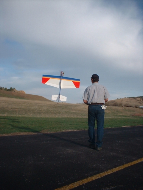

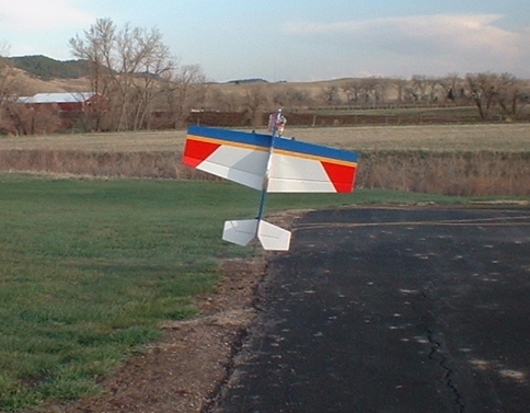

One Item I didn't see that will help allot. Once you establish the plane in the hover the worst thing you can do is to back off the throttle when you get out of shape, add power let the plane fall off into level flight and try again and again and again ect ect. Rule of thumb is 2 to 1 power to weight. so if you have a 5lbs airplane for good 3D an engine with at least 10lbs of thrust is needed correct proping of the engine is important also larger Dia. and lower pitched props produce more thrust at lower rpm than smaller Dia high pitch props will. P. S. prctice practice pratice!!!! Than there is the hand launch into the hover ARRR ARR ARR
