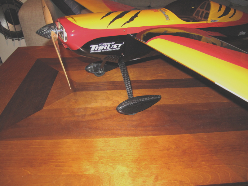

Revy's Avatar
Joined: Mar 2009
Posts: 775
From: Revelstoke, BC, CANADA
Default RE: Precision Aerobatics Extra 260 Power setup
You won it! Congrats, man!
I know I griped about the IPA, too. When you get it, you won't be disappointed! I am using 2250-2500 mAh packs, and getting alot of flight time. 15-20 min depending on what I'm doin'. Turning a 13x6 Xoar with the CF spinner, now, not in that pic. That was with the p25 in it there. I'm finishing up my CF wheel pants as we speak, I'll post some more in a bit. The wheel pants are far stronger than the 'glass ones that come in the kit. Personaly I feel PA should include them in the kit or an upgrade if you get the IPA w/ the kit. I paid a total of $50 CDN for the spinner and pants to show up at my door. Other than that PA's customer service, particularly Adad, has been awesome!
What color did you get?

Old 12-13-2009 | 09:03 PM
tiggerracing's Avatar
Joined: Feb 2007
Posts: 152
From: Cloverdale, CA
I got the red one. It looks so cool. I too will be getting the CF spinner and the CF pants later on. I take it you covered yours your self? Looks awsome. Its the first raffle i have ever won AND i also won a spectrum reciever! What a night.

No I didn't cover the entire plane, just got rid of the gray with a bit more visible color. I painted the cowl to closely match the red I added. Not perfect but you can't see it when its movin', lol!
This is a good place. Post pics and questions on here and within a few days you will find the solution to your question if the search method doesn't produce enough answers for you. I'll gladly help.
For the rudder CA hinges. They recommend using 30min epoxy. I did the same. Take yer time and tape everything in place so you don't get the dreaded setting droop![X(]
Old 12-14-2009 | 12:35 AM
Revy's Avatar
Joined: Mar 2009
Posts: 775
Oh BTW I did get the spinner and pants done.
