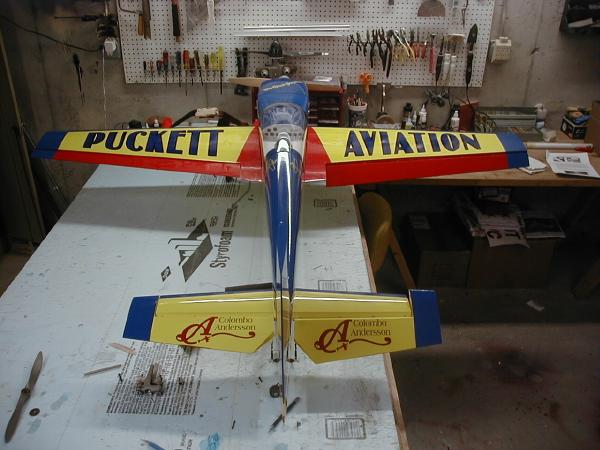

We put a ZDZ-50 in ours. It was awesome. I say was because we sold the plane. Probably the most stable plane I had seen.

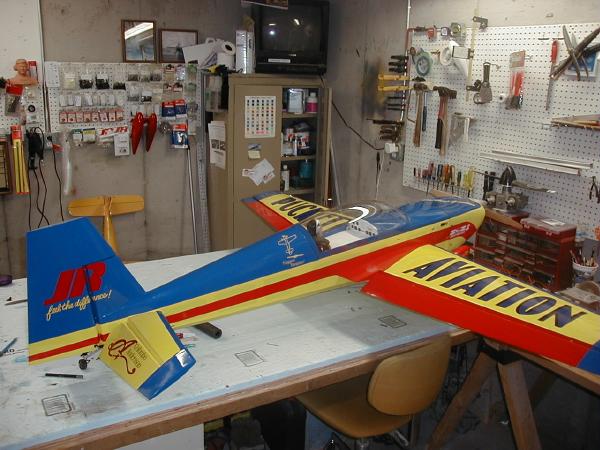

It now lives at "Planes Plus"
