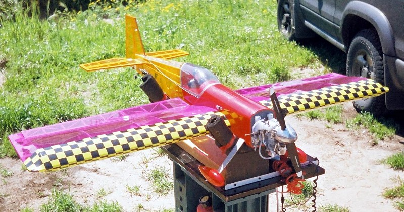

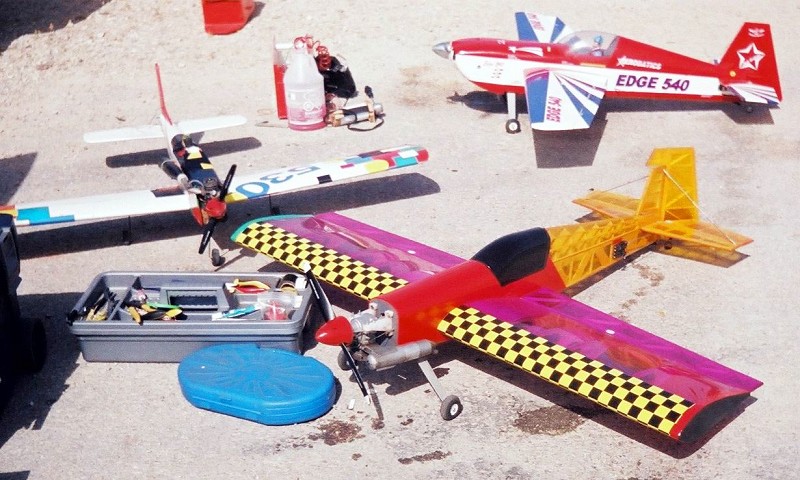

Posts: 1,687
From: tel avivna, ISRAEL
Default RE: drazzle 3d & Rossi 53
guys - we love the rossi but and the but is only related to the razzle and again the rossi will fly the razzle well even hover but we fly our razzle now only with a saito100 or 91fx and the plane loves over power - we had to strengthen the tail but thats it -
