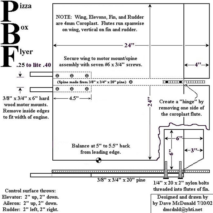

there was a huge thread about the pizza box a while back, i believe people are flying combat with these, especially hovering combat where the impact damage is minimal.
what on earth do you want a pbf kit for???? they are so easy to build!
heres dave mcdonalds plans-the father of the pizza box

Buy some 24" x 24" of coroplast sheets from www.harborsales.net and get to work with them. Buy a cheap 25-40cc motor with 4 standard servos, 3 12" pushrods, and 1 6" pushrod.
Follow the picture above for building instructions. I will highly recommened buying an OS 25FX as they are QUALITY motors and actually much more worth it in the end.

The Dave McDonald PBF takes about 3 or 4 hours to build. However, I think ARFS are available here, www.boogerboyhobbies.com.
