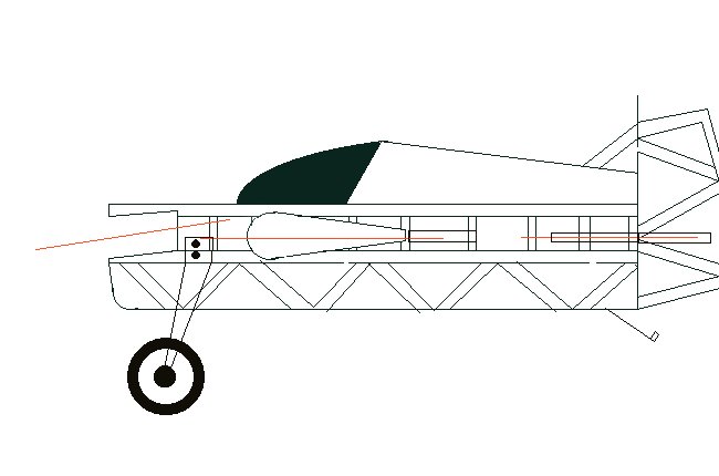

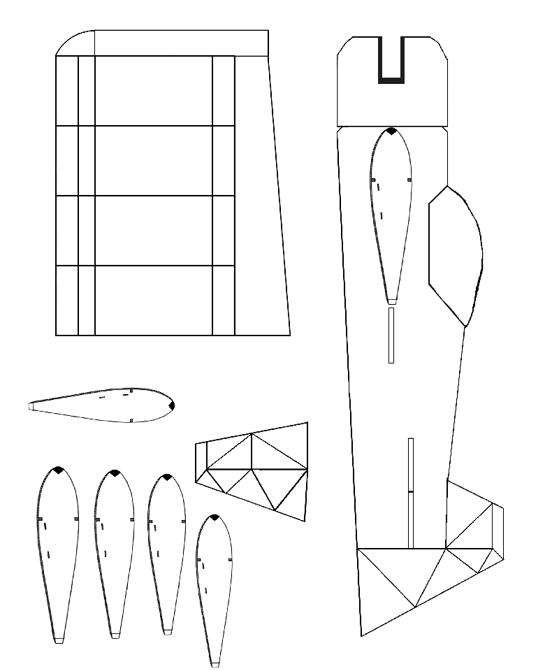

Hi.
I have written some plans for a 3d/fun fly, plane and i am new in rc airplane, so I want some suggestions about my plans, which balsa wood i should use and which motor and stuff like that...
It’s around 1m in span and around 1m in length. it has a cord of 32cm. airfoil is from the indoor fun fly "tiny"
Hear are the plans:

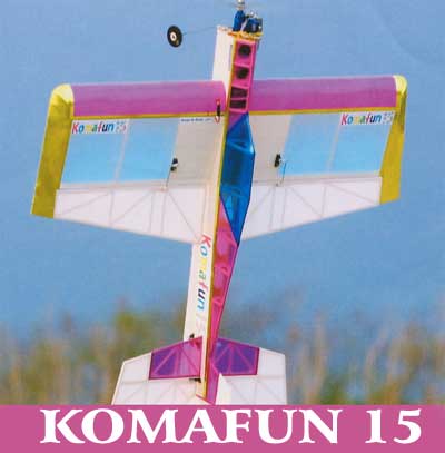

looks about right, use some stiff wood for some stringers down the fuz and spars, the rest should be nice and light.
engine, ummm 15-25 should be about right, all mini gear, micro on the throttle.
it reminds me of the japanese plane, K something, komoro? i dunno, Cartman will, also much like the Fun15...
keep it light, have fun building and even more flying YOUR design

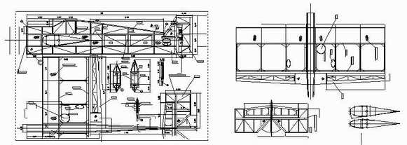

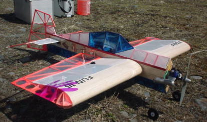

Cartman will
indeed i do.
komacro or fun15, both for 15 (ish) engines and micro gear.
i got the idea that you might be talking about a pprofile model, if so, you want ply at the front for mounting the engine, balsa around the wing and tailplane mounts and then sticks for the rest of the shape, then-sheet the lot, itll be very very stiff with all the mounting points underneath the sheeting.
by the way, you said you are new in rc airplanes, if you mean you have no previous experience then the best idea is to get a trainer.
much as your design looks eminently workable and good, its no trainer.

NEO, its vital to get the downthrust line (if any) perfect on a profile model (i think its a profile) as you can not adjust it easily if req'd. A mistake some designers /kits have is no downthrust. If its very light and well powered you will certainly need some downtrust, and it looks you have none. A way to get the thrust bang on is to make the bearers undersize, i.e. narrow by about 5 - 8 mm and bolt the engine on as far up as it can . note some of the body of the engine will fit into the gap so mightent be as extended off as you might imagine. Note weights might be req'd to wing tip, fly just long enough to check the vertical lines, if req'd remove engine and cut in more thrust, less thrust line as req'd.

no, you still want down trust, you just need to get it right first time coz you can space out your engine mount like with normal firewalls. you might be able to over size the holes and clamp it with washers, it'll allow slight movement after.

ok, heres an example of how i might roughly do it.
you want solid areas around the engine mount, wing mount and tailplane mount. i use ply for the engine mount and balsa around the wing and tail, then build the shape up with sticks, then make a template of it- just draw around the whole lot, including the cutouts for the wing and tail etc.
sheet both sides now, sand back the edges until you meet the stick frame, lay the template on top and cut through to reveal the cutouts for the wing/tail.
as for thickness, i would use 3/16 for the insides of the fuselage like the ply/balsa/sticks, and then sheet it with 1/16 balsa.
