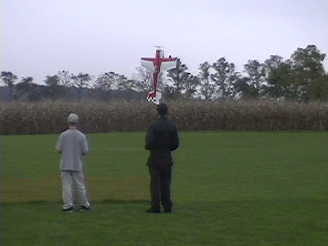

I have a flip(with the saito 72, good combo) also and i know what you mean about its wobbling. I dont tend to like the flip that much, my dad loves it. I tend to like the bigger and better planes that do great 3D and percision patteren.
Chris
