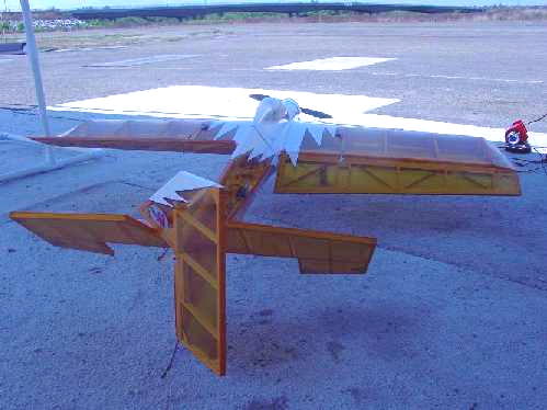

HEY GUYS,
ITS BEEN A WHILE IN THE MAKING BUT HERE IT IS. CHRIS BRISLINS SEDUCTION WILDSTYLE. FIRTS FLIGHT ENGINE SCREAMING(FINALY GOT THE TUNNING PROBLEM SORTED) THE PLANE LEPT INTO THE SKY. 2 CLICKS OF LEFT TRIM ONE OF UP. NOW INTO THE GOOD STUFF. THE 50SX HOVERED THE PLANE AT JUST OVER 1/2 POWER WITH THE 12.25X3.75. NOW THIS IS MY FIRST EXPERIENCE WITH 3D I'M NORMALY A PATTERN FLYER BUT ON THE SECOND FLIGHT I WAS BOUNCING THE TAIL ON THE GROUND LIKE IT HAD A SPRING. ROLIN CIRCLES, HARRIERS BLENDERS THIS PLANE IS AWESOME. THERE IS ONE THING THAT I DIDN'T LIKE THE PLANE SEEMED TO NEED QUITE A BIT OF RUDDER IN KNIFE EDGE BUT IT STILL DID A VERY TIGHT KNIFE EDGE LOOP. I THINK ITS BECAUSE THE PLANES A BIT NOSE HEAVY AT THE MOMENT.
SO ANYONE THINKING ABOUT BYING A 3D PLANE THIS IS THE PLANE TO HAVE:

Well I wanted one before, now I really want one.
Thats a 50 SX isn't it? What about the other set up (servos etc), and weight?

yep the 0l' os 50. standard JR 539's R700 reciever TY1 carbon pusrods on elevator an rudder 600mah nicad battery. sprink you have to get one! get in on the fun!

From a pattern pilot's point of view, will this plane do a real snap roll, or does it just do a fast and tight barrel roll?
Was there much coupling in knife edge?
Also, do you have a weight for this set up?

singapore charged $228 australian. and yes the wildstyle does a snap. but it has to be done at speed or the plane will stop half way through it. it only needs a little aileron coupling on knife edge.

Did you have a chance to weigh the plane yet?

my plane weighs slitely (10g) over the maximum limit as expected using monecote as it is alot heavier and thicker. so over all the plane weighs about 1.8 kilos or 63oz. the model is still nose heavy but it still hovers.

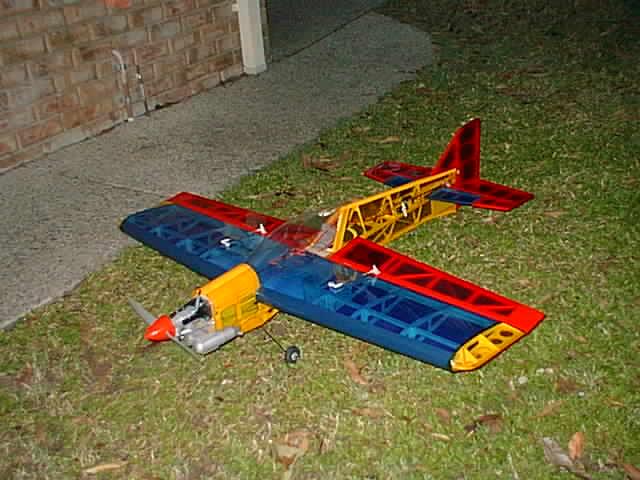

I cannot speak for Chris but mine weighs 4 lb 1oz. This is with the Freestyle swept gear (I made them longer by an inch) with wheel pants and full decals as shown on the box. Engine is Saito 56F. 800 mah 6volt JR Extra battery. Fun plane. Mine needed no mixing in roll coupling and only 2% in pitch.

Do you have any pictures?

Here is an older picture. Looks much better with the new additions. Unfortunately my camera is about 2,000 miles away. Can post newer pics after Thanksgiving.

yep! sorry guys i havn't posted for so long but i have been hanging around the pattern forum. jon596 where do you have the CG on yours at thge moment my CG feels nose heavy as it is a lot harder to hover than my friends seduction funfly.

I finally got around to measuring my CG. It is at 133mm from the leading edge, measured along the fuselage.
