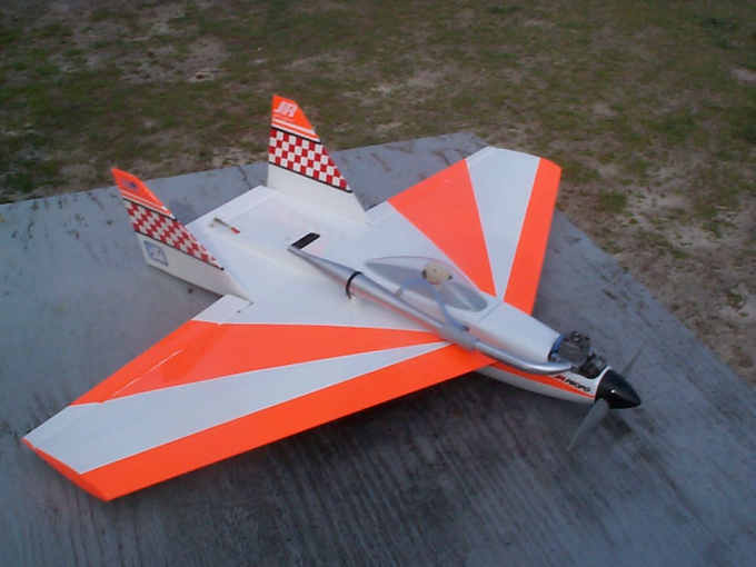

Has anyone used the OS .15 CVA engine before? I'm thinking of using it in the Mini 3D from Extreme. What I really want to know is how loud it is...kind of a tough thing to judge, I know....and this post may not get any responses .
I'm looking to fly this plane in a small field a mile away from my home where some guys are flying strictly electrics. I'm trying to decide if I'd become a nuisance or not. I know that .049's can have a piercing scream and I don't know if this little engine would fall in that category. I wonder how this engine would compare to say a 46FX? (which I consider to be fairly quiet).

I ran my engine today for the first time and it's really not too bad at all. I'll bet it's smoother and therefore quieter than the LA version (not that it's super quiet mind you). I started this hobby with an LA 46 and then noticed how much quieter the 46 FX was when a buddy got one. The same thing may hold true here. I think I'll be happy. Thanks again to all for the input!

Well I've run one tank through the engine and it's not bad for the noise. At the very least it won't be an issue at the little field I'll be flying at. It's a nice engine.
I have yet to finish breakin but I did get one reading of about 11,500 rpm using that prop (9x4). For the most part I was running it very rich and under 11k. We'll see what happens on the next tank when I get a chance to run it again. If flight tests suggest that I should change props I will...but I have no desire for speed with this plane so I certainly won't change the pitch. It's a new experience for me to run an engine of this size. Eventually I'll find what combination works best. I appreciate the suggestions. Still, I was impressed with the video I saw so the 9x4's gonna be my starting point. Someone in another thread suggested that the combat fliers are using different props, but this isn't going on a combat plane it's going on a Mini-3D. The slower I can get this thing to fly the better (but there could be an 8x4 in my future...I'll at least have to try it).
