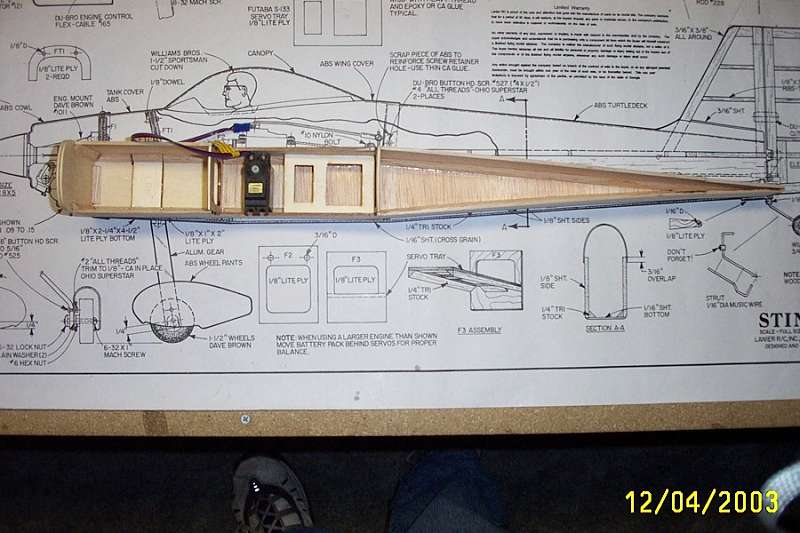

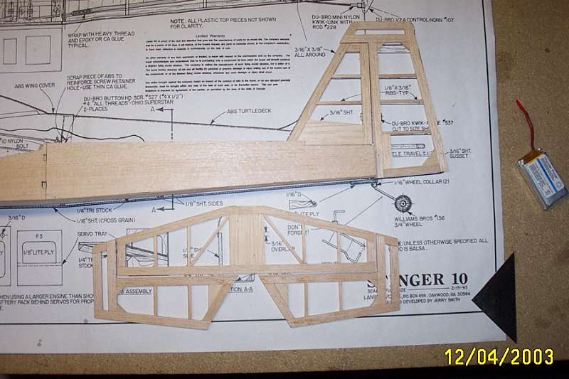

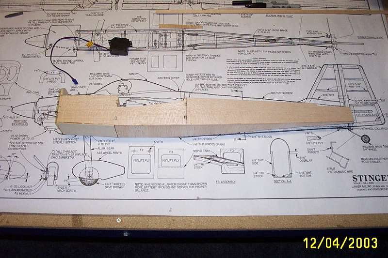

The flying weight is advertised as 29oz - 38oz on the box, so take that how you may. Here are a couple pix of the current situation, the servo in the pic of the fuse is a standard sized servo spanning the wing cradle gap to give you a size idea. The others are the tail that I added counter-balances to and a couple other small things.

Boogie - I know its supposed to be a heavy model, I dont want it as a primary 3D machine, just a little fun thing to blast around with for fun and really wring out. I dont like HS-81's for controls on gas planes, Hitec told me right out that they are designed for gliders and the vibration of the engine when used for anything other than throttles will strip them out quickly. My brother and I put one on each aileron of a .20 sized plane and they were missing teeth within 10 flights... with slightly oversized strip ailerons. Switched them out for metal geared ones and so far they're fine. Maybe HS-85's? havent even really looked into it much yet. Why do you frown on the tuned pipe idea? I want a big prop, fairly low pitch to still fly the plane within its realm of safety speed-wise. I want it to tumble good and hover, thats about it... and be a bucket of fun o'course

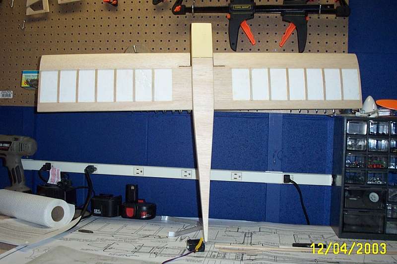

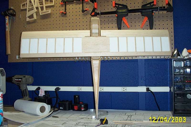

Beardking - The cowl is 2pc as well as each wheel pant, dont think I'll be using either, very flimsy, but its a little plane too I guess and they are trying to keep an already too heavy (from what I hear anyways) plane as light as possible. I want it to be as light as possible without weakening it, thats why I'm leaving that stuff off. Otherwise, everything fits fairly well and builds extremely easy, I've been working on it in my free time for a couple months and its just about done. It could easily be built in 2 weeks. Foam wing, just waiting for glue to dry there to go on to the next step takes more time than anything (using foam safe glues). It is set up for one aileron, could be set up for two fairly easily as long as you keep them inboard enough to stay on the sheeted area. Dont think you'd want them out too far either because the wing is solid foam, you'll have to auger holes through it somehow for the servo wires and keeping them close would make this easier. I dont know if I'm going with 1 or 2 aileron servos yet. I'll post a pic of the wing so you can see what I'm talking about, it is partially sheeted with cap strips for the "rib" look.

One of top and one of bottom, the wing is one piece out of the foam block so there is no center to drill into before you glue your halves together for the servo wires.

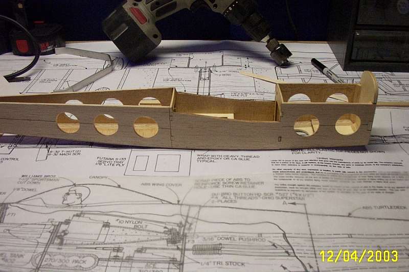

The freshly butchered fuse pic [>:] Have room for 4 more holes at rear but not sure where servos need to be yet for balance and they will need wood to mount in if one or both are in the rear A touch under 1/2oz lighter. May auger sheeting under servo tray too, not sure yet tho...

Your gonna pepper that firewall and the landing gear plate right? If your gonna go light you might as well do it the right way . Now you got me thinking about dragging the old stinger 10 out and modifying it to death.
Old 12-05-2003 | 12:20 AM
My Feedback: (16)
Joined: Apr 2003
Posts: 483
From: Azle, TX
Default RE: Anybody fly Stinger .10 in here?
Might as well go ahead and cut away some of that excess foam too.

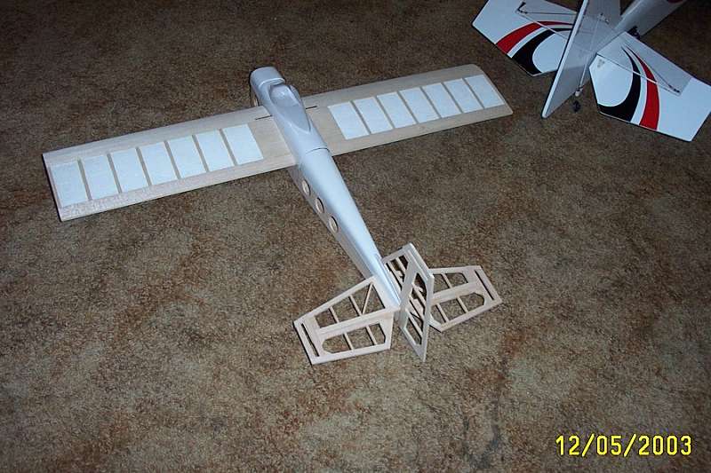

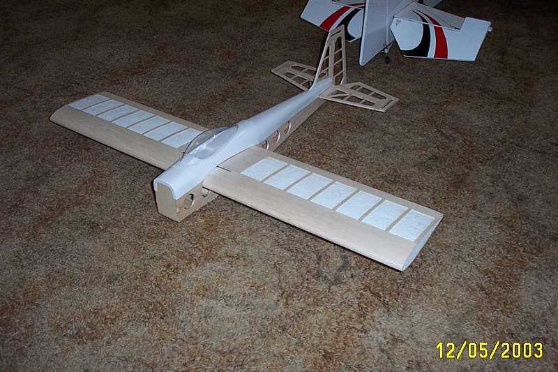

Couple more pics of the progress, just about have the airframe completed.
