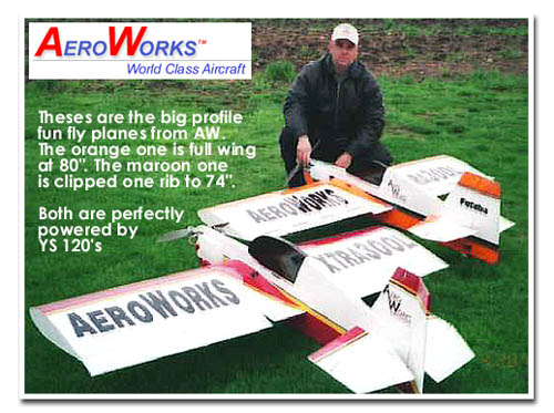

My YS is the same as yours, I believe. After the air chamber but not the current engine. It just says 120 F on it. I liked the 17x6 just great, but it was NOT the best hovering prop actually. This prop and engine is on a big profile fun fly plane. I started wth a 16x10 on it when first bench running the engine. My buddy and I had each just rebuilt a pair of these 120's. I have tried the 16x10, the 16x8 and the 17x6 . As far as best prop in the powerband at hover, we are all in agreement that the 16x10 is the most cointrollable. We're talking about subtle differences, though, an I am being nit-picky.
I lost the 17x6 prop to a lean run caused by a teeny fuel line leak. The YS coughed off the spinner, nuts, prop, washer, etc... The prop was damaged. I then went back down to the 16x8. Great thrust, but wrong RPM when in the hover zone. I am flying the 16x10 again this afternoon. Even though it seems wrong, it IS the best performer for me and I will stick with it.

Interesting....

Billy Hell, you are one funny guy, but very likeable. It's funny how you strike me as one who really wants to absorb all the knowledge that is available in this forum, or anywhere, but you do refrain from asking a lot if silly questions, like many others at your level do. Cheech did bring up an interesting point. The prop producing the most stationary thrust, may not be the best prop for hovering and TR'ing. It oftne depends on at what throttle setting the prop/engine produces the thrust needed to maintain altitude. A prop that produces the most thrust at WOT, may not produce a whole heck of alot below say 75% throttle, so to hover, the throttle has to be well above 50%, which to many is to high a throttle setting. I do like a prop which is not very jumpy, so I can blip my throttle in large blips without having the plane jump all over the place, but it induces good TR, I guess I like a "soft" prop.

That's what I meant by interesting. I would never have thought to go that way. The great part is I have a bunch of props and will be out bright and early trying them out. Reading Cheech's post opened my eyes.
