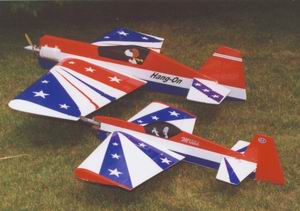

I've got a plan for the 80" span version of the Su-Do-Khoi (Profile Sukhoi) and also have a new Moki 1.80 looking for a home.
Will the Su-Do-Khoi live with modern 3D machines like my Funtana or is it a waste of time building it?
If it's a dud any ideas of a really 3D capable ship for the Moki? I'd prefer scale(ish).
Thanks.

It's a great flying. Can do anything except stalled wing manuvers (this wing won't stall). Hovering is a breeze, nice and big and very stable. I have tried it with a Moki 1.8 and a 2.1 both on MAC's pipes. Either one does the job. I split the ailerons to try the "crow". It will land at a near stop.
ID:	88590   Click image for larger version

Pity it won't snap. The instructions say it'll do an inverted flat spin (climbing if you like!) but I know what you mean. I have a few fun fly types that can get into an inverted spin but won't snap or spin upright without everything being just perfect.
What does your's weigh? My instructions say 13.5 pounds and I was thinking good hovering may be a bit marginal at that weight without resorting to a pipe and nitro. Whadyathink? Also any ideas on prop size?
Like your colour scheme - looks real good.
I was thinking maybe I could build the fuz' from thick polystyrene foam skinned with 3/32 balsa. Any thoughts?

I think mine weighs about 14 lbs. No problem in hovering. I can keep it in a hover while playing with the throttle having it bounce up and down. The Moki's put out a lot of power. I have not tried it with out a pipe but you don't want to use more then 5% nitro on a Moki. On the 1.8 I was using a 20x6 and getting about 10k rpm. I know the 2.1 will "rip" a 22x8 static. I don't know about using foam on the fuz. It would be difficult as most of the electronics are in the fuz. I did run CF down the sides because I had problems with other profiles breaking behind the wing.
