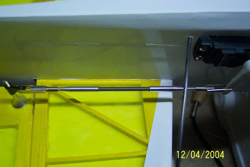

What about a 2-56 fully threaded that is sleeved in carbon tube JB Welded on? They seem pretty rigid despite being fully threaded, and on the test batch I made, they were lighter than 4-40, and they certainly are easier to set up while eliminating a Z-bend. I decided to try this on my Funtana, I had extra threaded rods that I normally don't use, and though "what the heck!." there is no visible wire, just carbon tube with Dubro ball links at each end.

This is what im doing on my funtana!!!
Carbon rod and M3 aluminium fittings on ends www.Petetindal.co.uk
Very good I think.
