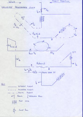

ere you go chaps heres the unlimited schedule. Will copy terry's drawings and scan them in in better detail when i have the time.........

T W - thanks for installing the sequence Luke, at least now most pilots will perhaps begin to see what has been constructed & why. All comments are noted & very welcome.
Obviously it would have been a relatively simple task to have made a 3d sequence, but seemed rather a waste when you guys will have at least two shots at total freestyle. I was indeed tempted to include, say a torque roll, within this sequence, but that cannot be fair. With freestyle, pilots can do as they wish, they are not compelled to do stuff that they or their models may find less 'compatible' with their style. But if I were to include 'compulsory' 3D stuff @ this stage it could be dangerous.
I'd like to think any Unlimited pilot + model could tackle the sequence proposed & it differs sufficiently from most other forms of aerobatics to, hopefully, make it inspirational. Naturally it is impossible to satisfy every pilots differing preferences, but amendments to this sequence can still be implemented if demand is high. Due to the considerable amount of options, this sequence can be flown very close in, certainly far closer than F3A or even IMAC, stands to reason the spectators wanna see everything!
The multiple day event raises similar problems, some pilots can only do the one day. We are however, very fortunate to have the opportunity to use the site on the Saturday prior to the RCM&E event, allowing pilots to 'familiarities' if they wish. In time, particularly if this event ever becomes International, (I'll never be able to handle that), it would prove more worthy of debate.

I think terry's got the right idea about leaving 3d fun for the last two rounds. Still gives you plenty of opportunity to pack in those harriers e.t.c

ORIGINAL: loadeddice
Advanced will have some Knife flight, don't be in doubt about that! Keep the suggestions coming so I can construct that programme appropriately, ie how much 'tamer' it should be.
eg I would hope that everyone in advance is comfortable with rolling circles? but rolling to knife edge then doing the circle then rolling back to normal for the turn around is a bit too much for this level? Fixing the number of rolls would also be too much.
I think I am saying that it should have the same number of manouvers, just spread out a bit more, and tamed down a little bit.
I do not agree that the more extream 3D manouvers should be included. Many of the planes at last years event would not be able to do things like harriers and torque rolls. Nor is it necessary to do them to please the crowd.

I have to say i'm very happy with the new proposals. Having round one as a fixed shedule will probably mean my plane will last at least 1 1/2 rounds!
I think the advanced program should only be slightly less tricky than the unlimited one because at the end of day its a national comp so the pilots entering are assumed to be good! The advanced class will clearly attract those attending for the first time... but may also include pilots who have aircraft that are simply less capable than a Capiche 140 for example, so its clear that the routine needs to be a little more simple. I just hope its still a challenge.
That said i've every faith in TW as his revisions so far for the 2004 freestyle are in my opinion spot on!

T W - As I promised, I'm staying with this as much as I can. The RCM&E article, which basically confirms the format for this year, will be sent by the end of this week.
The fact that F3A programmes are more intent about 'lines' than flown figures means they will always require around 10 minutes of flight time. The Freestyle 'fixed' programme is a 4 minute. Naturally it's a dynamic programme, (always something goin on). I believe that the 'Advanced' pilot would appreciate a little more 'breathing space', consequently is required to be a little less dynamic. Also their models will invariably be somewhat less potent, so a vertical snap for instance might be impossible.
Rolling circles for Advanced? I was thinking a knife edge circle, 1/4 roll in & out. Is that too tame?

to tame IMO. The rolling circle is an easy maneuver to do but is hard to do well. thats sorts the good from the not so good
Knife edge circle, actually up until recently I think I would have preferred the rolling circles!!
Hmm presume both would be a bit too much[&:]. Toss a coin if you cant decide! Only thing I would add is that more variation is available with a rolling circle. (ie number of rolls, type of rolls etc). Knife edge circle is more about precision, only variation would be do you start belly or canopy towards you. Depends on the other manouvers around it I suppose.
