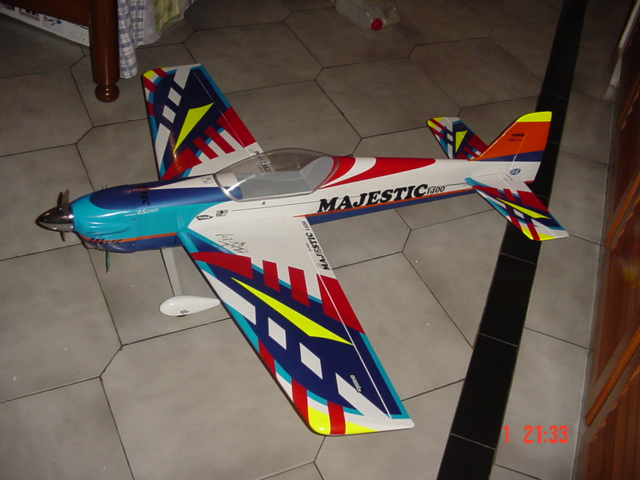

Hi, i'm new to this forum and would like to know about ur experience with the kyosho majestic. i'd appreciate detailed insight.

I have one that has flown all winter and if I lost it I would definately replace this airplane. It is not 3D as billed though. Its a pattern plane that loves to knife edge. It is very precise. Mine is flown at 35% on low rates and 80% on high. This plane is rock solid when on final as long as you are nose heavy. There are a couple of things to change. Pushrods to fiberglass, reinforce the firewall, Sullivan tail wheel, and a large servo arm for the rudder. Many forums have been written on this plane, can't remember a bad one.

thanks man! Makes me feel i made a good decision. is this plane meant to be a little nose heavy? If so, i suppose it can do a little hovering too. At least i've tried to n it worked. I'm flying this thing on 60% D/R and 100% on full rates. Are the control throws sufficient?
Secondly, what could be the next step if i'd want to move onto a rather smart plane and yet try 3D?

I like mine to be nose heavy, have tried flying it balanced on the CG and it was a hand full. I have hovered mine but not to long and not close to the ground as you should to do it properly. As far as rates go I have mine set on 40% aileron and 50% elevator. But I don't know what my throws are at that setting. My high rates are set at 80%, Its to tough to fly at 100% the way that mine is set up.
This plane is not a 3D plane, its a pattern ship. 3D planes are not supposed to be fast. There are many good ones. Would not know what to recomend as I do not fly one.
