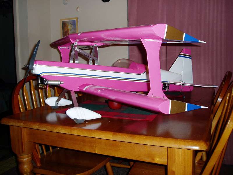

I use hobby lobby bulk c.a. hinges in everything except g-62 stuff. had a few sig e-z hinges crack over time, and never liked the cut it yourself thick g.p. ones. Hobby lobby hinges are thinner, and laminated with a papery layer instead of the fiber stuff. I have been using those exclusively for over 3 years now (just bought another 800- I build a lot for people) and have not had one for sale. they are in my 3d bipe, omp edge- it is over a year old and been ABUSED!- my phaeton 90 w/ 31cc ryobi, my g.p. giles w/ saito 100, my 120 mph 1/2a w/ a 25 stuffed in it- I only use 3 hinges cut in half on the ailerons on those- a profile g.b.,and who remembers all the rest over the past 3 years. NEVER had any problem with those hobby lobby ones. had a g.p. decathlon, and slotted the struts where they joined and used a hinge for a joining "biscuit", and that worked well also.
as for me, I abhor pinned hinges. I don't like the way they look, kinda sloppy; or maybe it's my installation? speaking of that, I think installing them SUCKS!
have used robart hinge points on my big stuff, they work well for me, and if recessed a little they will have an acceptable hinge gap. I use monokote continuous hinges on my 15 and smaller stuff.
http://www.hobby-lobby.com/bulkthree.htm is the page with the hinges, 4.30 per hundred. they don't look as pictured, though; now they have rounded corners, which insert better.
here is my 3d bipe, full fused sig ultimate. about 80 flights, plenty 3d time, got 45' elevator throw. all hobby lobby hinges.
by the way, I don't use crayons or anything, just slot and c.a.; I use only bob smith c.a.

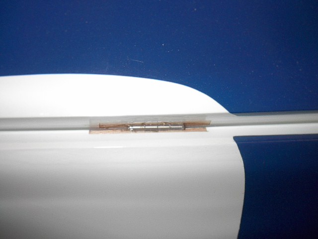

Hi Wild Fred,
In regards to "sloppy hinges", it is not nearly as easy but extraordinary results can be obtained with pinned hinges. The right tools, the right methods, and the time are the big factors. Cutting slots for CA hinges and then gluing all together takes an hour or so for a 2 meter F3A type airplane. Flat-bladed, pinned hinges, done for professional results, takes closer to a full day in working time and must be done in steps. First making the slots, cutting out the middle, then cutting neat and clean recesses takes a couple of hours alone. After covering the airplane, it takes more time to grease the pin, time to get the glue into the slots (not too little, not too much). Depending on what epoxy or glue you are using you may be able to glue only one surface at a time or even only hinge first the control and then attach it after the glue dries.
These are issues that prompted me to use CA hinges, but after the time invested in repairing split CA hinges of all different brands, I decided that the time necessary to install pinned hinges nicely was worth the additional hours. I still have a DP Ultimate waiting to have the hinges changed after the hinges cracked. The change will take more time than if I had simply installed my favorite pinned hinges to begin with.
Last year, I wrote an article on how to build an F3A airplane in the Pattern Forum entitled "ZNLine Factory: Enigma Building". If you look through that article you will find quite a few posts on how we hinge our models using pinned hinges (photos are done in quite good detail). I feel as though our methods provide the best, cleanest results possible for the type of construction and are applicable to almost all conventionally attached control types. I would be honored if you would search that article and take a look at the hinging work. I did not take any finished photos but the results are perfectly clean, no glue seepage, or fogging of the covering near the hinge locations.
On another subject, very small airplanes with tiny and thin control surfaces do not benefit from pinned type hinges and require other techniques to adequately attach the controls. Continuous monokote hinges or CA hinge slivers do work well in those types of installations. Of course, little airplanes are their own specialty.

Here is the link to the article with the hinging details. Hinging starts on page 5, post 134 or 135.
http://www.rcuniverse.com/forum/m_53...factory/tm.htm
With ARFs, modifications of the process are obviously necessary, but the hinge locations are already defined so only enlgarding them and cutting recesses is necessary.
