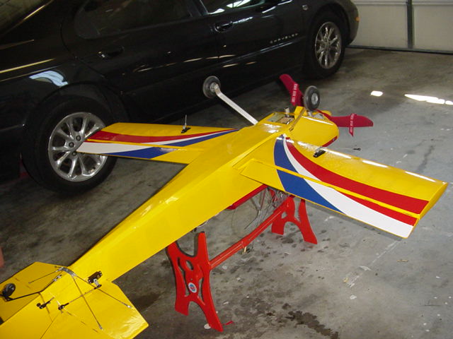

i am putting the finishing touches on mine its a bob godfrey stick build with 70.5WS and 77.75 lenght running a bme 100. i have the following on all my 3d planes
elevator 10/40 low and high rates
ailerons 20/25
rudder 25/40
those will always get you in the ball park for 3d i use the degree meter from central hobbies to set all those throws. The bigger birds will fly with a very aft cg. i am about level on my cg range for the maiden this week; however, i do have the 3d rates ready....

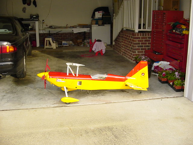

i mounted my wheel pants so i will be doing like you and getting my maiden over the new few days it the rain doesn't come....

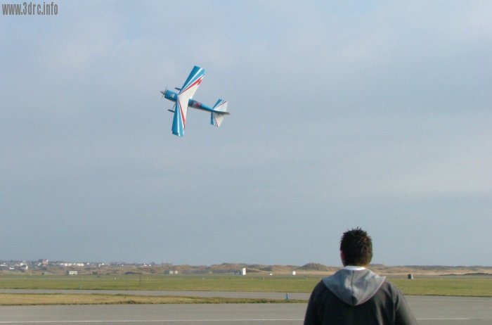

Got a few pics from the 3rd flight
Pulls out of the hover like nobody's business!

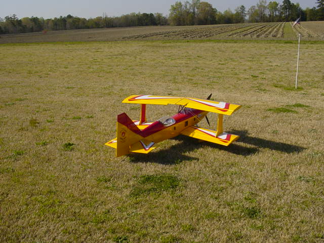

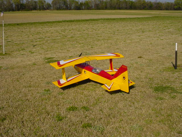

Welsh3d she looks sweet + u r doing your thing.
I did my maiden today no one was at the field i got the usually on the ground pic..
my camera doesn't have a great zoom even it someone would have been there u feel me....
my ailerons are super fast on high rates i have 20/25 on my ailerons rates, 10/40 on the elevator. i am almost finished on my knife edge mixes. I think i am aft on the CG as i have a bit of down elevator which is causing my uplines to pull toward the wheels.

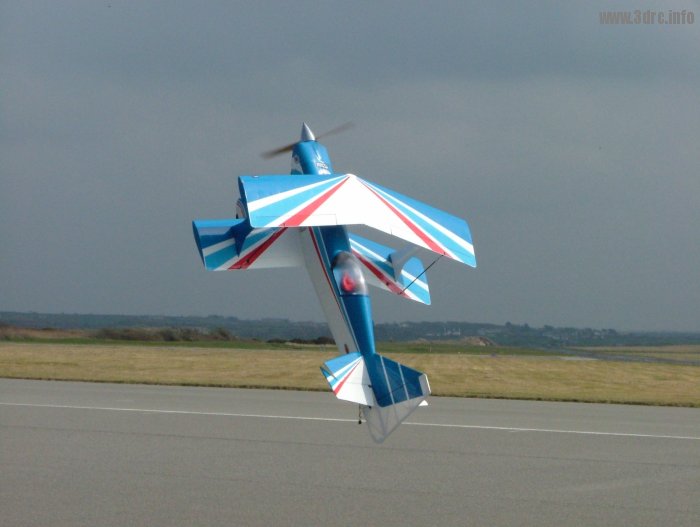

pics from yesterday.
