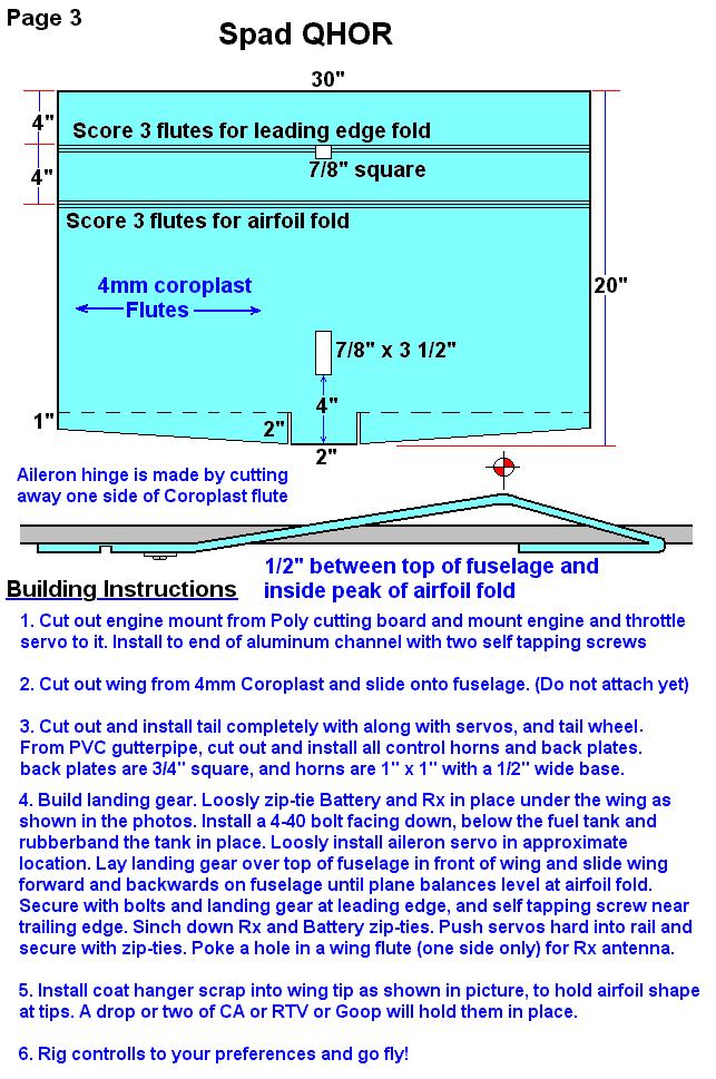

qhor has no wing section at all just flat sheet.
dont need symmetrical section for aeros!

Yes QHOR have no airfoil , picture from : www.spadtothebone.com\SPAD\index.html

Flat sheet can be used, the stuff you see in a SPA3D works I guess, but I always prefered a proper section.

I think it has to do with the fact it has no proper section. Because its not really genarateing lift like a proper section does, by air pressue differential, it doesnt stall like a proper section ie "wing rock"
