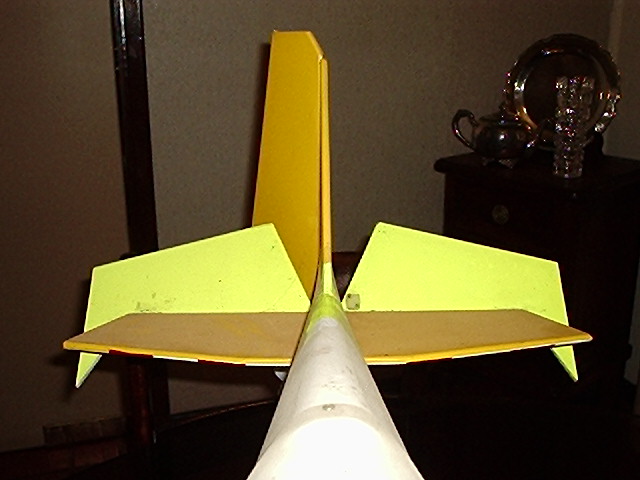

I don't know why i don´t load my images of ultimate, but I insist don´t do anything . Put your engine and fly,
Put the elevator in 45Âş and fly (with the batteries back) and tell me if you need more elevator.
Do a hammerhead and put all the ruder and look the Ultimate go anyway, you don´t need more ruder.
Do Snap and stop in level with all the controls full, Fly and feel the airplane and later if you see you need more , ok put more.
Sergio

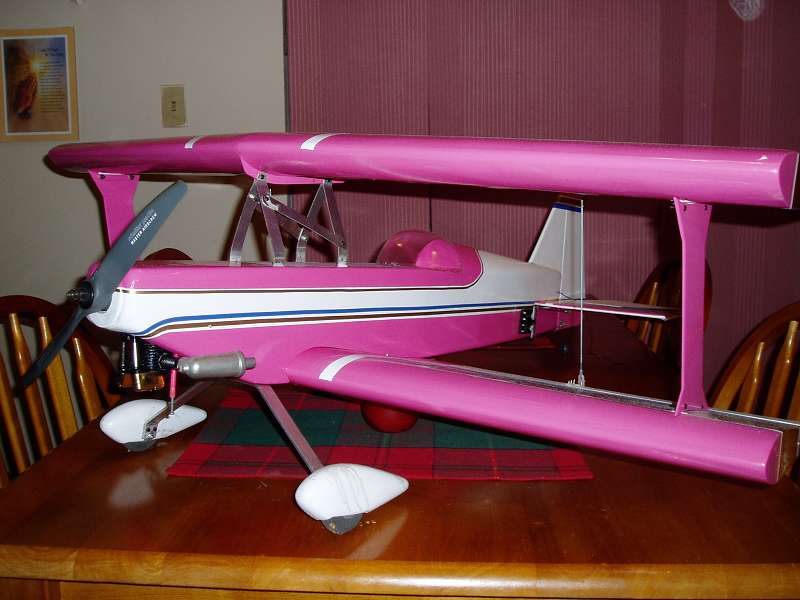

Old 04-27-2004 | 09:09 AM
wild fred's Avatar
Posts: 1,046
From: , FL
Default RE: Hovering the Ultimate40
I tend to agree with ****cano; my sig one is hinged at the center of stab, and 45 degree throw is plenty of elevator. definately keep it as light as possible. it will harrier better that way. as weight increases, so will wing rocking. mine is pretty good, will rock slowly when harriering below 45 degree nose up. one thing to watch for, though; if you go a little over 90 degrees while stationary or backing down, it will torque roll so keep that in mind! mine is saito 72, 4.75 lbs. does well. hope this helps!

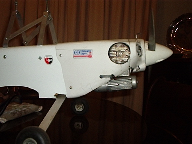

Old 04-27-2004 | 09:43 AM
EL TEMUCANO's Avatar
Joined: Jan 2004
Posts: 513
From: Temuco, CHILE
more pictures
I can´t load images sorry
