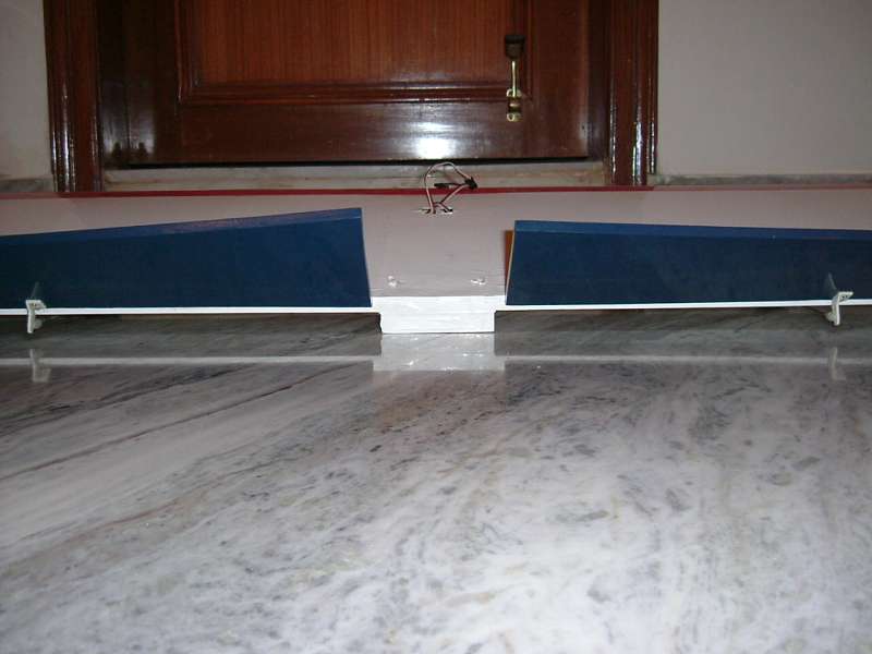

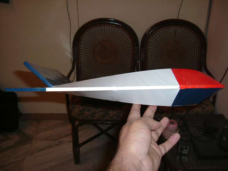

Hi
Below are a few pics of my 3D model with OS 50SX. The wing span is 56" and wing area is 950 sq. in. including the ailerons. The area of the ailerons is 205 sq. in. including the gap between the 2 ailerons which is about 20 sq. in.
The roll rate is too slow..... about 1 roll in 1.5 seconds.
How to improve the rolling???

Maybe you could increase the throw??

Just wondering if your servos are stout enough. My Funtana rolls faster at 1/2 throttle then it does at full throttle. The 9101s are just not strong enough to hold full deflection at full speed.

Maybe try setting up differential ailerons.

don't have so much taper, wider at the tip would help, have you sealed the hinge line, that will improve roll rate. Its strange that is happening as they look big enough and have more than enough deflection. Tapered back leading edge would help but reduce your wing area.

Increase the throw on the ailerons. You can also add aileron throw to the elevator if you are using split elevators.

I was gonna say seal the gaps, but they look pretty tight up to the wing. Shouldnt be too much of a problem. The ratio of aileron area to wing area may not be perfect. I have found this out on foamies a lot. If they dont have enough aileron area, they dont create a powerful enough airfoil to overcome the resistance of pushing the wing through the air. On this plane it shouldnt be too bad of a problem, just throwin out ideas.

The throw is approx 45 degrees. Will increasing this help in rolling faster or create more drag?
David:
Your reason seems very logical. I am using Futaba 3001 and I feel that at low speeds the aileron is really responsive.....it becomes difficult to control the model while landing at high throws. it is quite possible that due to the high speed, the servo is not holding the ailerons. i have a few 9202's lying around..... must try those next time.

Another thing to think about. Those ail's are pretty thin. Is it possible they are flexing under load when being pushed to full deflection and not giving you full roll rate?
A case in point is look at the FuntanS's ail's. These things are very thick at the root and are very strong. The servos need to push them but if they flex, they will not be effective.

i've also found if you have too much throw it doesn't help. the ailerons will only be effective to a certain angle. try giving a little less stick in a roll to tell. full 3d rates aren't necesarily the most manuverable, only help when little airflow going over them
