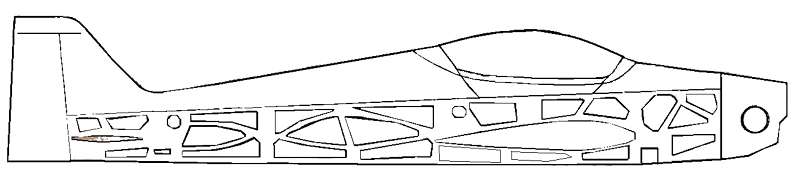

I designed this airplane with the concept of pattern performance.
Though my inspiration was the CA epsilon.
I would like your comments about it

Looks Great!
What are the measurements?
What Motor?
Airfoil?

Tail moment looks long. What will be the benifits there? Not good for 3D? But better for sequence work?

Well the fuse length is 65 inches and wing 63.
I am thinking to use atleast a .90 thing. (Probabally Magnum XL)
I am thinking to use the G Trick's Airfoil. What do you recomend ?
Mark , I designed it for pure pattern performance .... but what do you think .... will it be capable of doing AA ?
What should be the ideal wt. when it is ready ?
