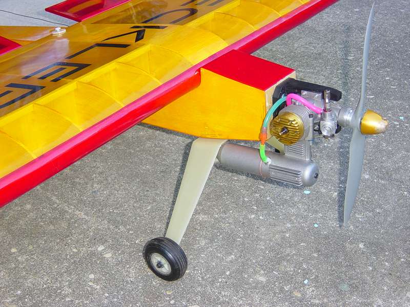

I side mounted the engine since it put the carb pretty high above the tank. You'll need to angle it down slightly to clear the gear. I mounted the engine before I checked muffler clearance so I had to go to a wider gear, a KrazyLegs gear.
