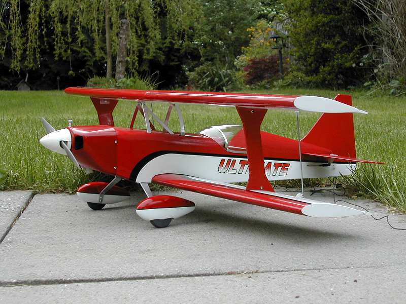

The DP Ultimate 40 is an awsome little plane.... I didn't know you could stil get it?!!! But if you can find one (and it's not ridiculously priced) I'd get it in a heart beat. Mine is powered with a YS 63, loads of power.... acctually this is the first plane that I could get to hover at 1/2 throtle with the reccomended engine where I fly at 5000 ft ASL!!!! As for 3D capabiulity It's got it....But I'm not too good 3d'n little planes (things happen faster than my thumbs can keep up with)...45 degrees throw is easy to get out of the rudder and elevator. Plane knife edges solidly with very little coupling with the elev and ail. It's by far my most favorite plane I've had in it's size range.
As for my setup.
YS 63 for power (plenty of power even at 5000' with air densities as high as 9000 I bet)
HS 5245's on Elev, rudder and ailerons, and a HS 81 on the throtle
Pull Pull on elev and rudder, with the elevator servo mounted under the cockpit (only Mod made)
balances with the battery (1200 mah 4.8V Nimh) about 4" aft of the CG
Do a search in the ARF section for it.... You'll find lots of good info, and several good pictures on it along with the moveing of the elevator servo to a better location for pull pull geometry. There is also a review here on RCU that Mark did..... he also did the elevator servo relocation, and good info! The only thing I would have done differently is to mount the engine inverted for better lateral balance and engine cooling.
Ohh look...I found some pictures of mine!!! (I've since moved the battery back to where the RX is)

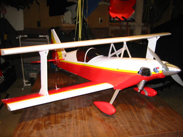

I just ordered one of these and found this thread while looking for servo suggestions. The comments about it getting small in a hurry made me grin. Compared to my current Ultimate (25" span - picture attached), this thing is huge.
