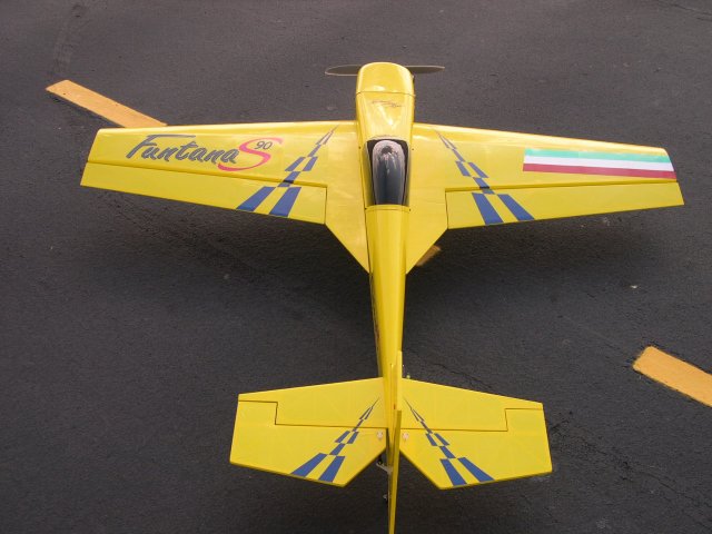

I was just asking around if anybody is catching wind of it being an easy plane to snap, thats what I heard so thats why I started this thread.
Plane - The plane is actually one of the best diverse planes out there to fly, I have flown just about everything out except a jet which who 3D's with a jet ? ha ha
Engine - Ive been hearing alot of things about overpowering and its bad its wrong its evil. I had a YS 1.10 on my Funtana 90 and it flew pretty well, could use more power when needed. SO I upgraded to a YS 1.40 Sport on it and it flys even better with unlimited power.
Flack - I got so much flack about putting the YS 1.40 on there but in reality is that the people giving the flack has never flown the plane or hovered it with a YS 1.10 over the deck.
If the airframe is going to come apart, its usually not the power that kills an airplane, its the speed.
Questions For Others : What are some of the engines you all put on the Funtana 90 ?
