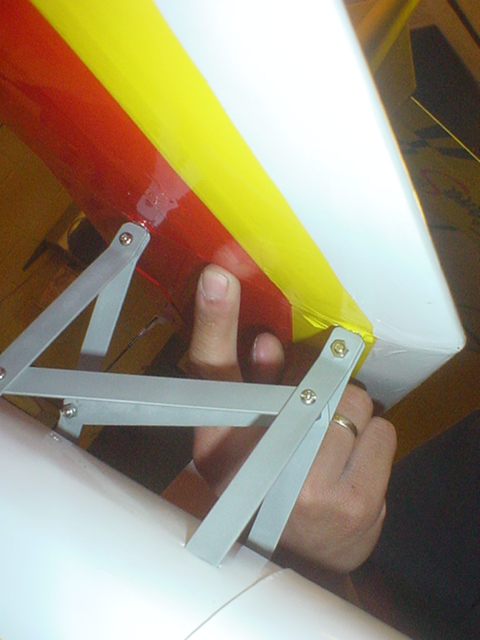

Has anyone had cg problems. Tail heavy- Engine OS52- 4 stroke. Tail Big time. Mini servo's. Before I remount the engine and move forward. Also whats with no decals. Instruction tell where to place them but the kit come without. Called Cermark and they told the kit dose not come with decals> Hmm- something sounds a little off,

Ok I must be doing something wrong. According to the instructions 3/8 to 3/4 from leading edge of rear cabane. I place fingers there -tail heavy. If I extend out to wing tip will come more into balance. Broke gp cg balancer. Have pull pull all around with mini sevos. Its just some dump thing Im doing. I think I going back to my Pitts .
Bob
Bob

What I will do later on tonight is take a picture of what I use as the balance point. I also have the Great Planes CG machine but simply balanced it with my finger at the stated CG location in front of the Rear Cabine. To make this clear I will take a picture for you tonight and it should help you out. This is a great little bird, however, I guess mine had a few issues which you can read about in this posting. Hope this will solve your CG issue.

Here are the pictures that I promised. There is one view each; looking from the leading edge of the top wing and also looking from the side. I simply used the finger method as stated to balance it out. I found I had to move my battery pack to about under the canopy to balance it out nicely. If you need more weight in the tail, you might just try a heavy tail wheel. I am using larger foam wheels up front and a Klett tail wheel because I fly from a grass field. I hope these pictures help you. For anyone interested I have another one of these NIB I might be willing to sell.

Thanks for the infro. At least I known I'm not losing it completely, but that is what I was doing. So I moved the engine up 1/4"and moved the battery up to the firewall even doing that' it's not really nose heavy. Oh well I guess I'll test my flying skill.

At all costs I try never to add weight to my models. I think I have had only had two out of all my planes where getting a good balance would not happen unless I added weight. I just dont get how the that plane would still be tail heavy if you had the servos in the stock location. The only thing extra I have on my plane is a perry pump which added like no weight at all. Let me know how it goes. At least when you fuel it up it will make it more nose heavy! Of course it will get tail heavy as you fly, so just be careful when you land
