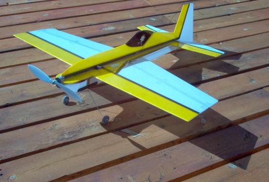

Here is what I did on my own design foamy.
You can just make out the antenna running down the fuselage, behind the canopy and up to the top of the rudder. The only thing holding it on is clear tape. Just make sure there is a little bit of slack so the rudder can move but not so much slack that the antenna can get caught in the rudder counterbalance. Has worked great for a whole summer of flying.
