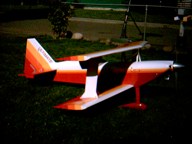

I havae recently purchased the DP 120 Ultimate with Saito 180 for power and need any suggestions as to engine mounting. Inverted or side mounted, muffler choice, fuel, prop?
This is my first large plane and would appreciate any info! Thanks

I have that exact setup, runnin a 18/6W ,15% and have the CG 1/2 " inch behind reccomended. I love it , super flying machine! BTW i mounted mine inverted with no pump .

I am using a standard glass filled mount, Works great, the vibration thing I think is more tuning than anything. RTF less fuel is just over 9 pounds. Its a rocket with the 180.I put a 24 oz tank in tho cuase IT IS thirsty!it will hover round half throttle. Has enuff to shoot itself out of hover too. i like the set up.
