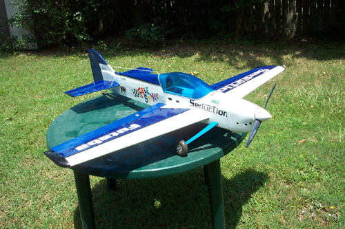

I am just starting to build the wing. The plans show only the right wing panel. How did you build the left panel ? I don't think it will be a problem, just looking for some ideas.

The truth is I didn't even use the plans, it pretty much all just slots together making sure the spar/ribs is at 90 degrees. The important part is the sheeting, its quite easy to get a twist so make sure you have a perfectly flat level board and weight every corner....

I agree, with the design that they used engineering the wing, it's almost a no brainer. Soo many cross braces (I think 4-5) the wing almost builds itself. I only casually checked for squareness on the wings, and they came out warp free. Of the entire plane, this is what I was most impressed with.
