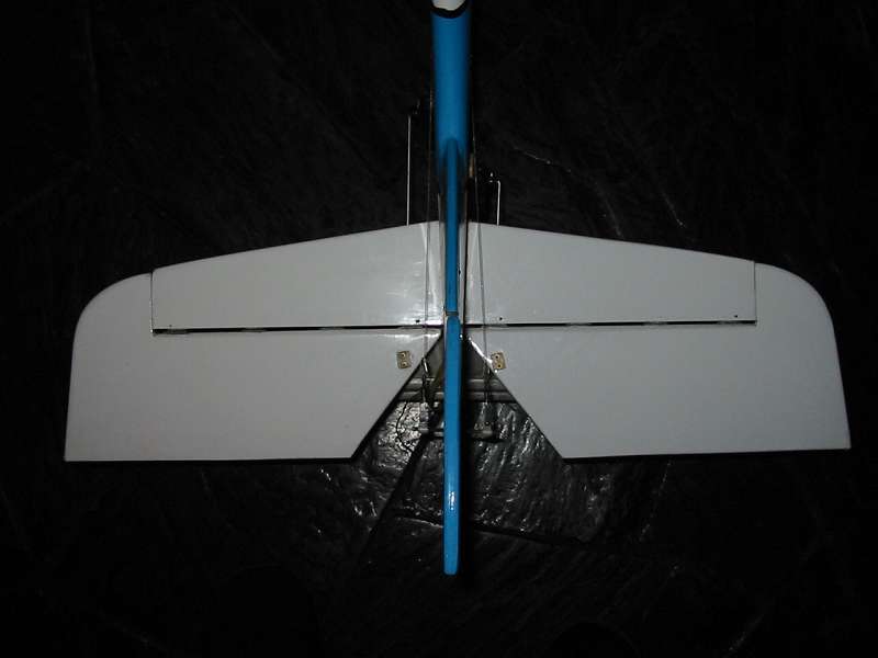

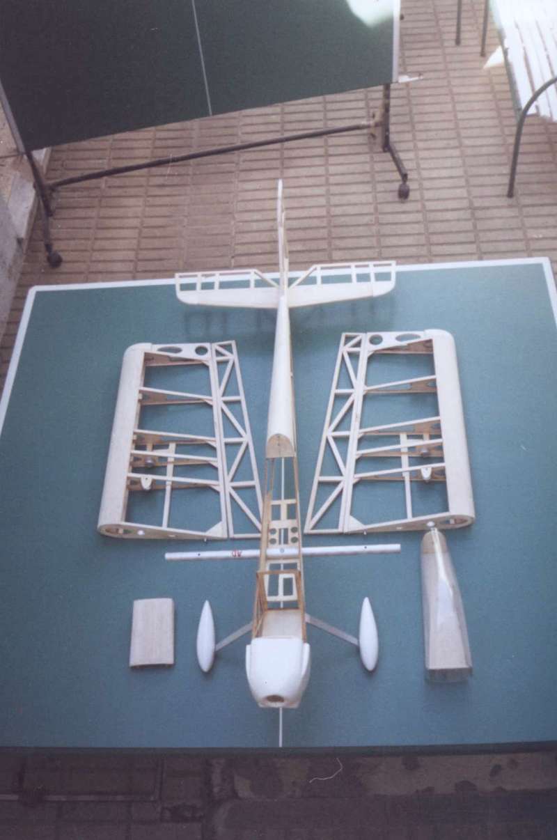

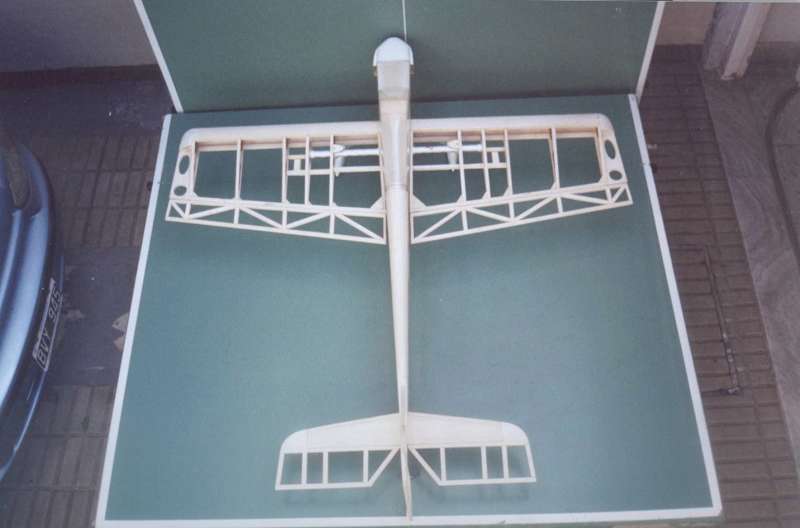

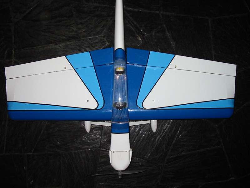

Hi, here are the plans(free!!!) of my new design. It performance for 3d are excellent!! i don`t have any manual but it is very simple to construct. The plans are already in Corel Draw, for the laser cut machine. The only thing is that i don`t have the plans for the rudder and the elevator, also te ailerons. Sorry, soon i will be posting plans for it. But for the moment use your imagination!!!
The ones that want the plans please send me an e-mail. The files are not suported to upload

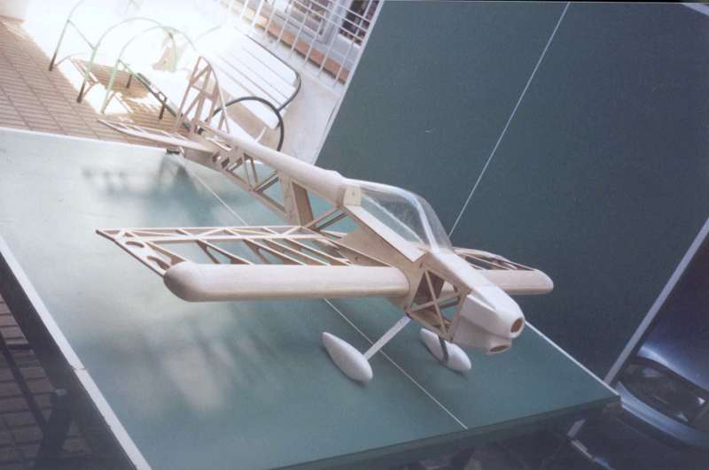

more photos

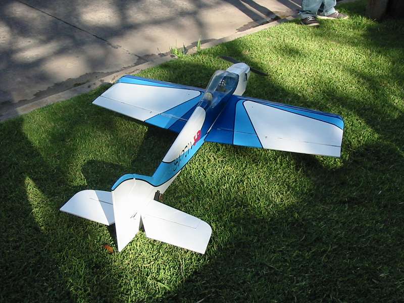

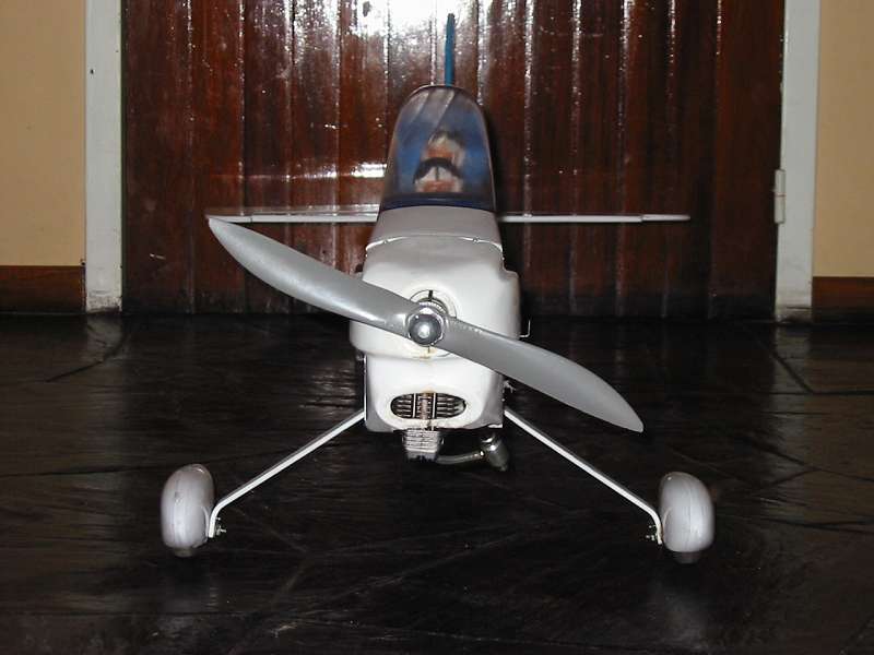

more photos. The wingspan:1300mm(52")
lenght:1400mm(56")
engine: .40 to .50 2t
weight: 2000 g(4.4 lbs)

how did you get around to moulding a canopy? whats your method?

i did the mold with hard wood, the one of the canopy and cowl too.

the fuse and the ribs are made of plywood of 3 mm

the 3 last ribs are made of balsa, the 2 ones of the root of the wing and the fake rib are made of plywood
