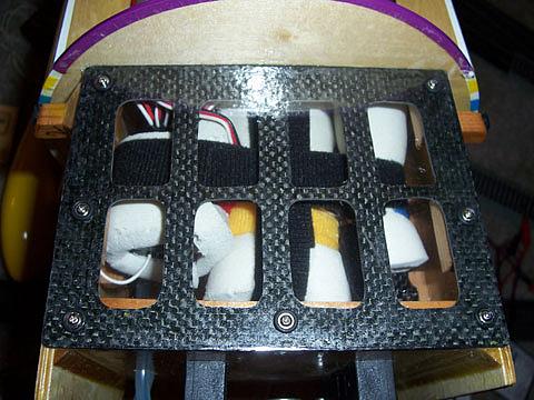

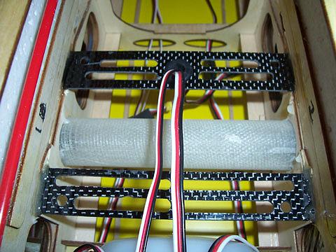

Default RE: Lighten up your 3D airplane
I am enjoying all the lightening ideas being discussed here. Keep them coming as I am one of those excessive lightening people. I have a 73" QQ yak(gen 2) around 10.5 lbs with a ys140 sport in the nose and gone through great lenghts to get it there. This season I will be adding a removable smoke system to it and will still have an exceptable wing loading. It is not fully installed yet but with all the components it just weighed in at 11lbs 2.2oz. If I can shave any more weight to make up for the 8oz tank of smoke fuel I'll be carrying on take off I am all for it.
Here is a few pictures of the CF mods I did. These are of my first yak but made the exact same modification to my generation 2 yak where the batteries and receiver are now back in the fuse.
ID:	884993   Click image for larger version
ID:	884994   Click image for larger version
