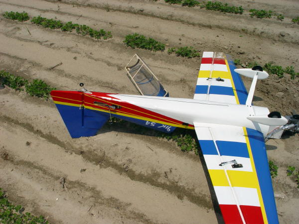

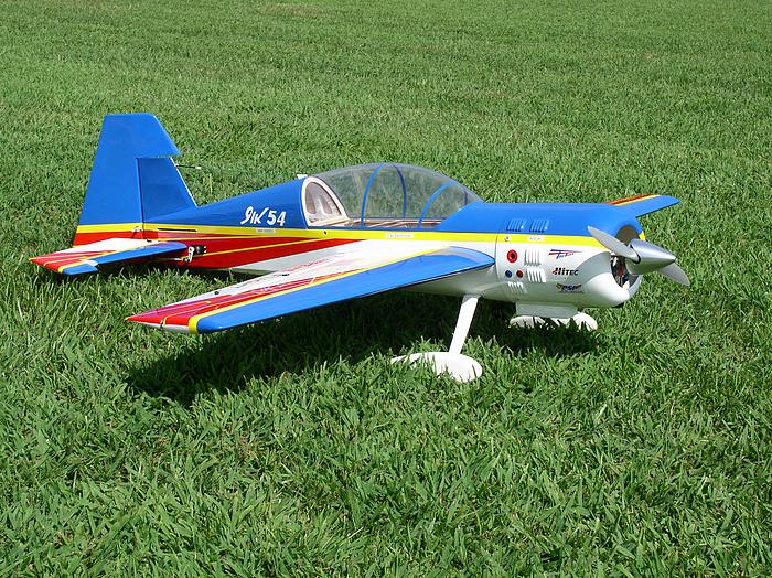

I own a Funtana 90 with a saito 100 that only gets 8800 rpm with 30% fuel. Dont tell me what to do about that because I have done everything and am sending it back to china to get the problem resolved.
Anywayse, I am gonna buy an EF YAK 54 68 inch span plane. is the ys110 enough for it, it just seems a little skimpy to me. does anyone sell the ys 120.
whats the best engine for this airplane, unlimited virticle with the ys 110 is there added noseweight that is bad with the 140?
please advise me! I will by what you convince me to buy!!!!!!!!!!!!!!!!!!!!!1
