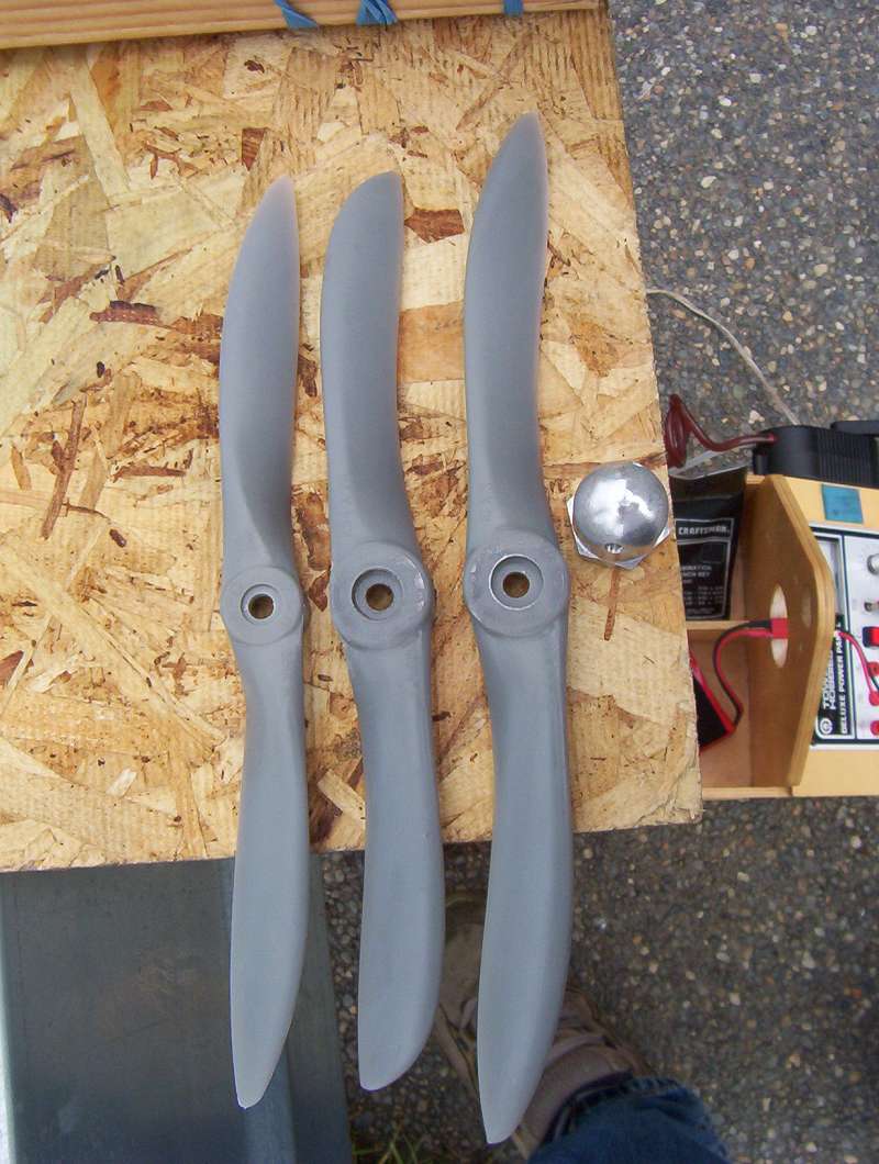

I am looking for a wood 10x3 prop for a .25fx that is going on a mini 3D, but it looks like no one makes one?
Current tach readings with apc props are
9x4-15,400
10x3-14,400
There is a noticeable difference in spool up with the 9x4--the 10x3 is much heavier--but at 14,000 to 15,000 rpms 3 pitch is all the speed I need so I would like to use a larger 10" disk.
Any help would be great.
