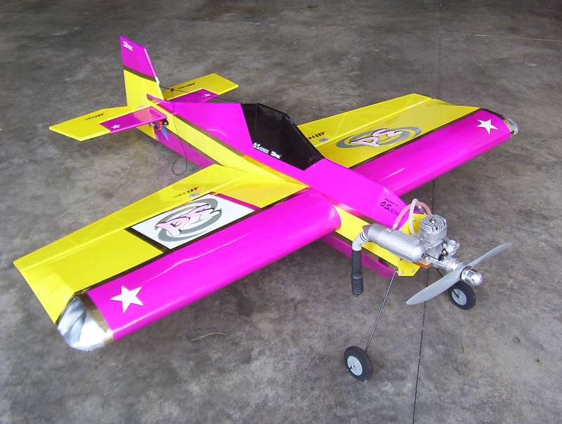

What is the better engine for this plane?

I think most will say .40 or .30 saito. I have a .25FX on my 2.5 pound Mini 3D and it is great with the 10 x3 or 9x4 apc!--Motor has never skipped a beat.

i have a YS-63 on mine. a buddy has a saito 82. hovers at half throttle . his weighs 4.5 mine a little over 4 lbs

Are you talking about this one?
http://www.kyosho.co.jp/web/products...lip3d25-e.html
Flip 3D 25
25 Engine Size (ARTF)
This is HOT NEWS! Just announced from Kyosho is this smaller 25 version of the CPLR design. Usual Kyosho quality throughout and a superb pratice design that fits into any sized car!
Wing Span (m) 1.24
Length (m) 1.25
Weight (kg) 1.4
Engine (cu) 25 2t

ORIGINAL: larorc
and 4 stroke? Saito 30 or 40 Os 52...
Not sure what the wing area is and how heavy these have been coming in? If it is 3.25 pounds + I would go with the OS32 or Saito 40.

Length 1,250mm
Wingspan 1,240mm
Total Weight approx. 1,400-1,500g
Wing Area 42.0dm²
Wing Loading approx. 33.3-35.7g/dm²
Airfoil 20% symmetrical
Engine(not incl.) 2 stroke 25 class
Now I have a thunder tiger gp 42 (357g 12,6 oz)
