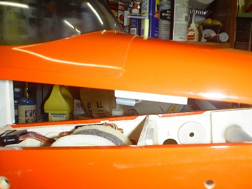

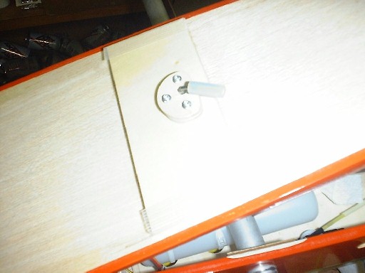

Looking for ideas on how to latch the hatch(forward turtle deck with canopy) on a typical 25-40% semi-scale aerobatic plane. Something other than bolts on the outside of the fuselage. Prefer some kind of kwik release system, so I can check things inside without using tools. Here's what I tried on my 25% Edge. Its a spring loaded hook that rotates under the fuselage former. It works nice and fast, but the hatch has a tendency to jump up and down at certain engine rpms. A stiffer spring is to hard to latch. I need a better system. Have any pictures of your latch system you can share? Thanks
Kevin

another shot

The hatch has a dowl at the front to hold it down. The problem is that the spring has a mechanical disadvantage, being located midway back on the hatch, pivits to easy at that point.
Kevin

dont mean to be rude but that looks worse than a bolt.
jets have a spring loaded pin that slides back to take it off.
i think bvm makes them.your lhs should have one.
good luck

I know its crude, but I prefer function over form. Bolts take to long, and shake loose to often. Thanks for your input.
Kevin

There was a great article in RCM a year or two ago with a very simple and quick latch system by a guy named Jerry Dale. I will see if I can find the article. It was on a 37% extra and used a small piece of wire to do the latching. Very slick IMHO.
I have used the BVM " Hatch Latch"for a canopy Latch at the rear corners and a dowel at the front on a 33% Laser. I worked very well for me and as you stated above no bolts to vibrate out and strip etc.

I looked at the BV hatch latch. Are those surface mounted with screws? Not sure how they would work in a balsa sheeted foam hatch. Thanks

I have been using rare earth magnets with great success on all kind of planes, pattern, f5b electrics and yet to loose a hatch or canopy.
geoff
