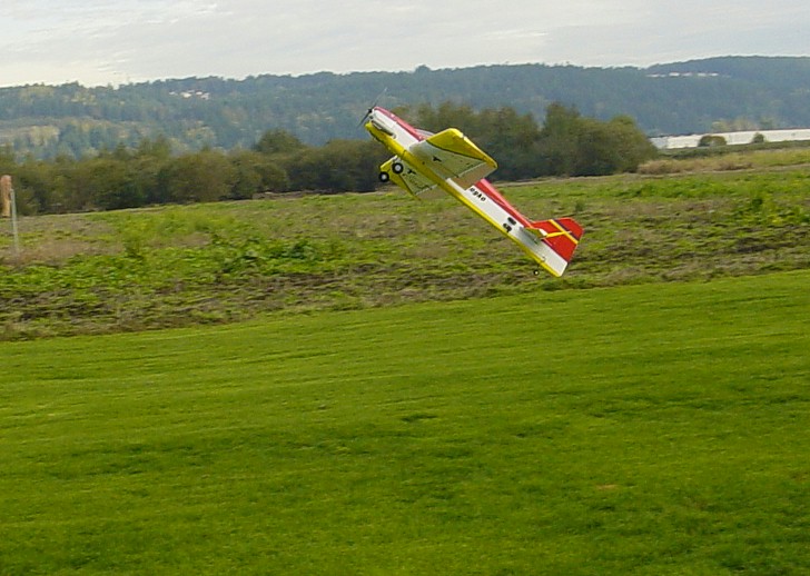

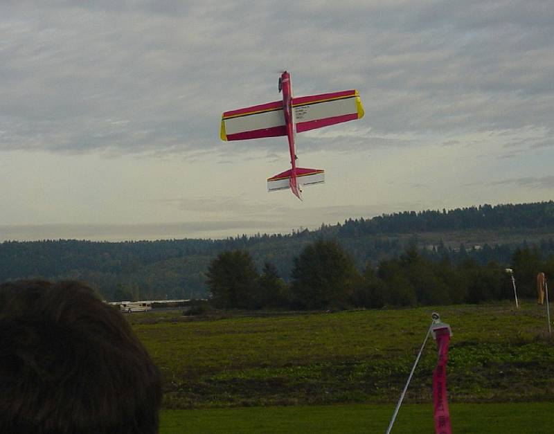

The Kangke Fun 50 will do what you are looking for. I have an OS 65LA in mine and it is a lot of fun. It would be even better with a 90 four stroke but the 65 is just over 100 bucks.
