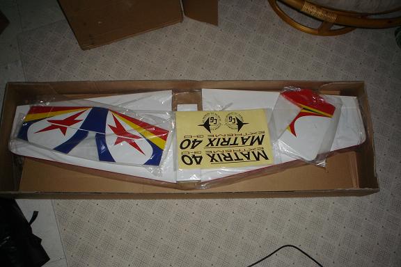

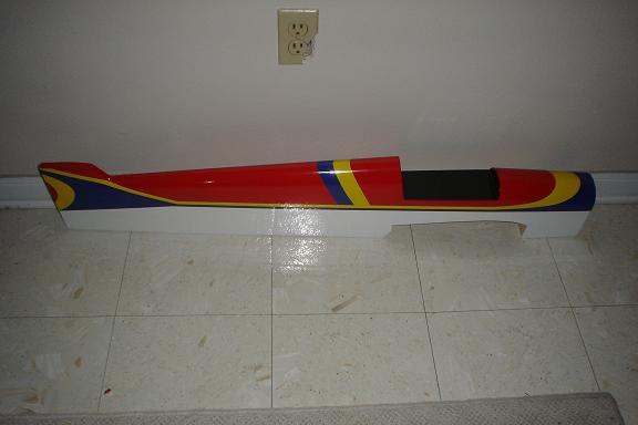

i just got a matrix and wanted to know your opinions on the plane and how it flys builds etc it looks good coming out of the box the only thing i don't like is how white the bottom of the plane is i might have to add some color to it so i can see it has anyone else had to do this I will be putting a saito 72 on it and will standard servos work ok and is there any reinforcing i need to do
