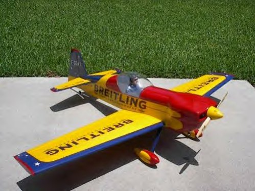

Heres a pic of mine. It has an OS .46 FX in it.

Here's mine. I finished it last Winter and flew it a bunch this summer. It's powered with a .61 FX and performace was very good. Depending upon CG, I'd se the elevator throw very small - say 1/2" up and down to start.
For this CAP 232 I had been in search of a CONVENIENTLY SMALL true flying acrobat that can fly with a degree of precision and be transported easily with the wing on. In flight I wanted uplines and downlines to be straight and I wanted it to fly the same inverted as upright. I wanted good vertical power. I had to change a few things. First I changed the thrustline of the engine. I added right thrust until it tracked great on the upline. Then I added down thrust until there was no elevator trim change between upright and inverted flight. I switched props around until I found the best for my setup and I cut more cowl away on the underside. The .61 was getting hot.
When finished with the trimming modifications I had a very true flying plane in a small package. The power to weight ratio and the wing loading is not there for true 3D style or fun-fly type flight. And although the small CAP a little eager to snap with too much elevator, it was fun to fly. My all up weight on this plane was close to six and a quarter pounds with NO ballast weight.
It was a nice plane, but I sold it back in August.
