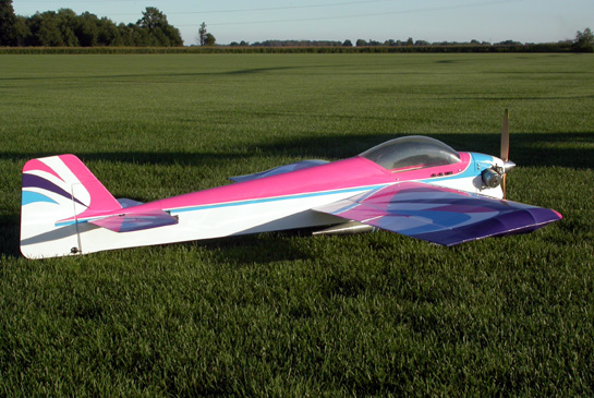

Here are some photos of mine.
Jerry[img][/img]

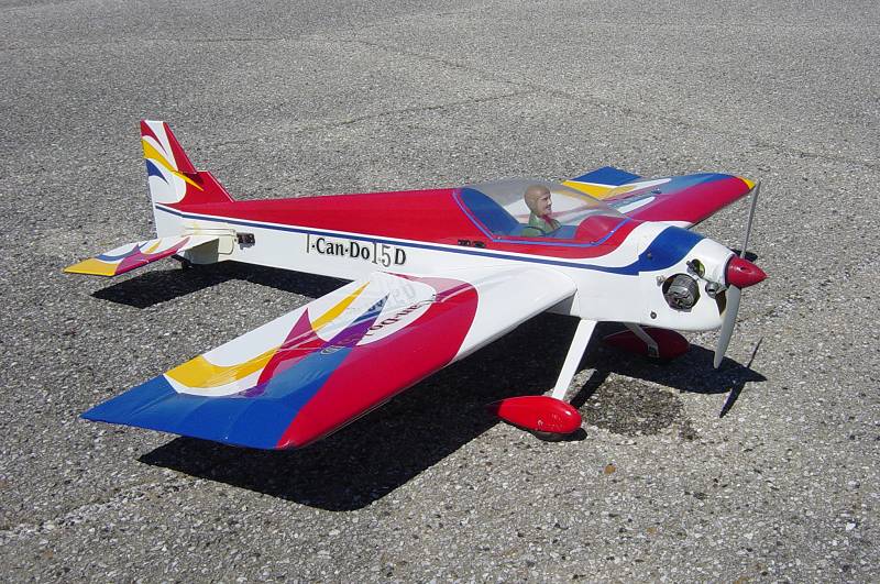

A friend of mine has a UCD 46 and has his Thunder Tiger .46 mounted angled downward so the muffler is on the bottom. The only thing you need to be concerned with is getting the tank-carb relationship correct. The center line of the tank should be even with or slightly lower than the fuel jet in the carb-nominally the center of the carb throat where the fuel enters.
He says he isn't a 3D pilot so he re-named it "I Can Do 1.5D."
