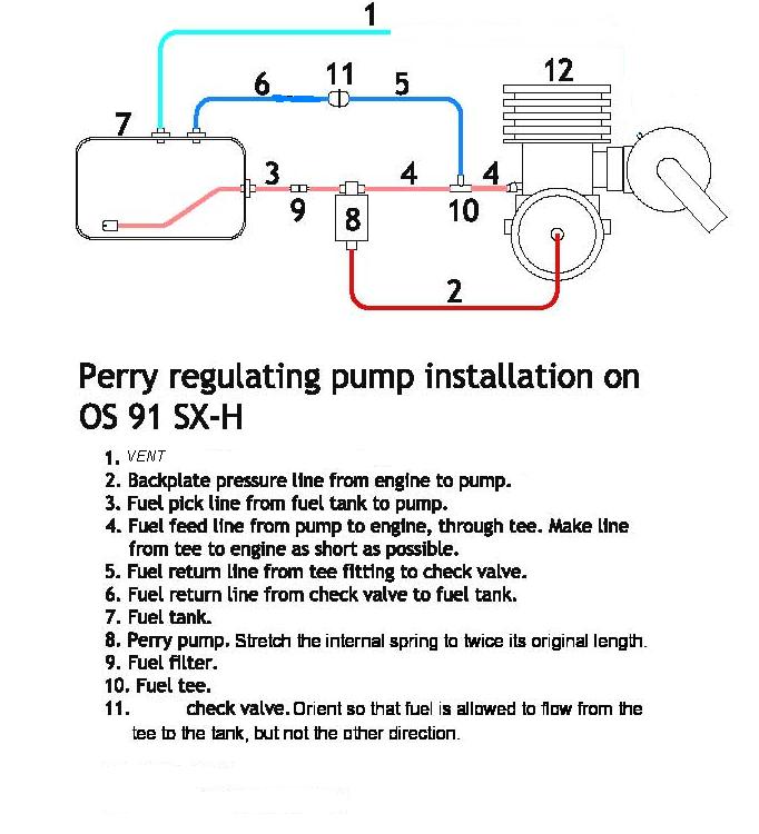

Hello everyone, has anybody used a perry pump on an O.S 1.08? and if yes could yuo tell me how it works, and give me the tips on it. I´m planing on using one on mine so I can place the fuel tank back on the C.G of my plane. Thanks much!

You will find the the carb on the OS108 will not allow you to adjust the low speed low enough to get it real clean unless you bleed off some pump pressure by running a bypass. I also removed my restrictior sleeve as it is not needed with a pump. See this thread for details.
http://www.rcuniverse.com/forum/m_28...tm.htm#2835580
With a pump my OS108 spools instantaneously. Click here for wave file of it spooling with a 16 x6 prop. http://home.comcast.net/~ccrsfield/108FSR16x6zing.wav

Thanks my friend, I would apreciate if you explain me clearly about the Y on the fuel line so I can do it just like you did, maibe with a grafic or so! I am down in Venezuela, I will let you Know the results. Expect back from you soon, I will wait for your reply to make my instalation!!!!!!!!!!!!!

Start with your low speed leaned all the way on the 108 and the pump fairly lean. My high speed needle is 2 turns out and not sensitive. I run 15% fuel.
You can T in to fill the tank at #3 or #6 below. If you T in at #3 (clunk) you will be able to drain the tank easy, but if you have an air leak you will have problems. Enjoy.

Hey STG! This is the first time I have heard mention of stretching the spring in the pump. I suppose this is to increase pump pressure. Could this be part of the reason I need to use the restriction in the bypass line? That engine is going back on my flying wing, and the tank is close to the engine. It will be interesting to see if it acts any different with shorter fuel lines.
raimondi STG and I have the same setup, with the exception of the muffler. He's getting a few more revs than I am with a bisson pitts, but the engine runs sweet with this setup. It will take a little tweaking to get it right, but it's not much work, and it is definitely worth the effort. I had to restrict the bypass line to the tank to get enough pressure to the main needle. Once I did that, all is well.
