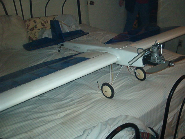

Here
This is my custom uproar. It is on a king size bed. in ouu guess bed room that is beside our attic where I store my bird in the winter. Wing span is 80".

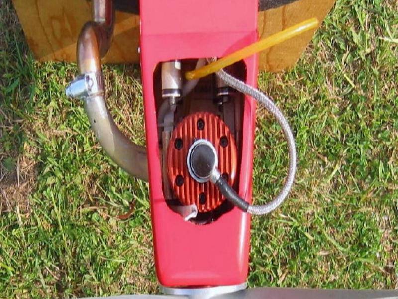

Here's a couple pics of mine MVVS 26cc gasser on a tuned pipe. Don't skimp on the ail. servos I originally used Futaba 9202, a very good quality coreless servo, stripped them very quickly ( no 3d ) and replaced them with some 5625's, much better. The only real problem with the plane is it is veeeeery heavy, 13.5 lbs and flys heavy. I would not buy another, it doesn't do anything really well, but then again it's not really my cup of tea.
[img][/img]
[img][/img]
