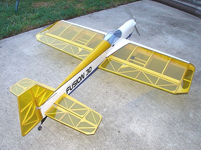

Default RE: first 3d plane
ORIGINAL: kzimmerman
I'm Looking for a good first 3d plane. I have a supertigre .75 sitting around that I would like to use, although I wouldn't mind getting a different engine if necessary. What do you look for in 3d planes? Is it better to go with 2stroke or 4?
Take a look at the Fusion 3D 90 from GCBM R/C. Your .75 two stroke would be great in this 5 pound model. [link=http://www.gcbmrc.com]www.gcbmrc.com [/link]
