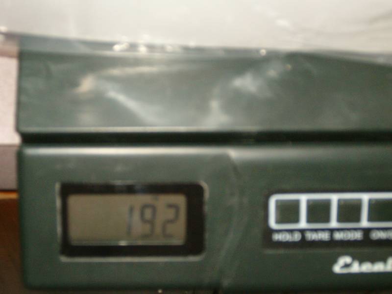

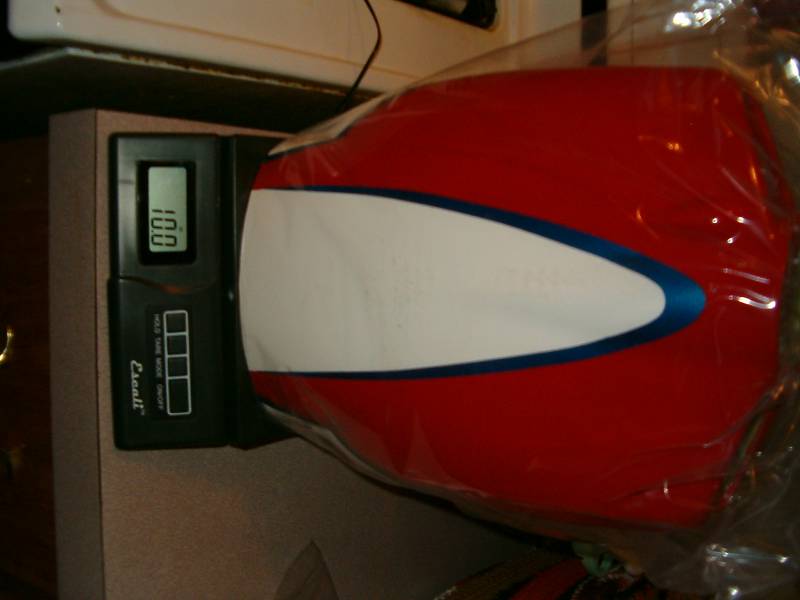

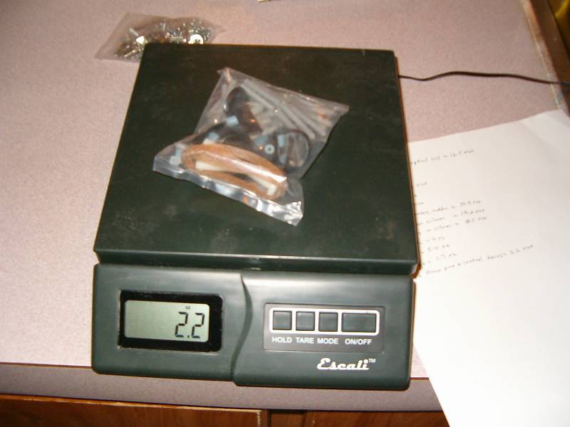

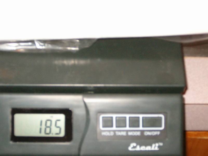

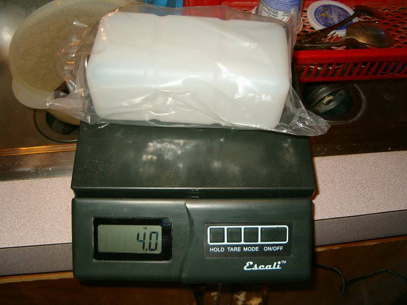

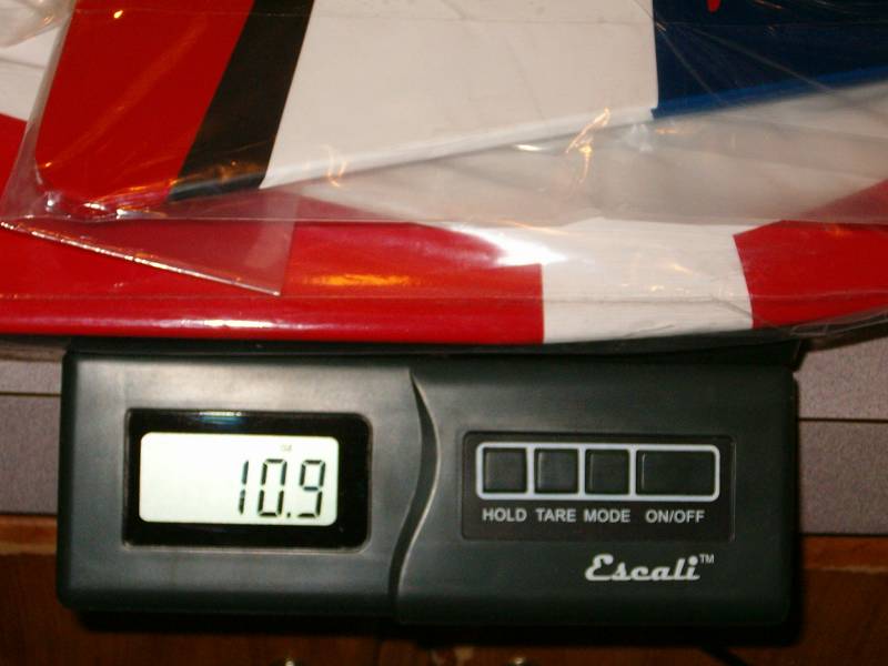

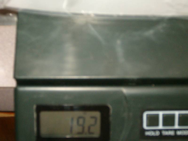

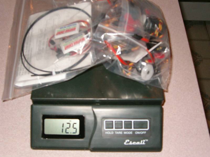

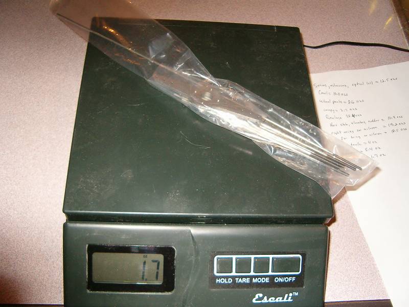

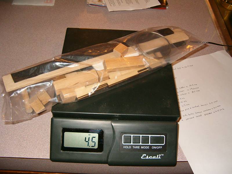

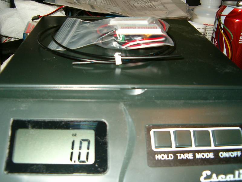

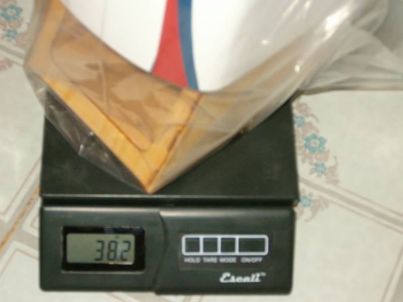

Here ya go everyone. I just got the weights on everything including pics. Everything was weighed in the bag right out of the box. The only thing I did not weigh was the Glow Engine mount. I'm waiting on the Fromeco setup and receiver
JR649 receiver at 1.2 ounces
2 Fromeco 2400Mah batt = 6.6 ounces
Switches and regulators 2.1 ounces
SmartFly Optical Kill = 1.0
3 Hitec 5945's and 2 JR125MG servos,extensions,SmartFly Optical kill = 12.5 ounces
Cowl = 10.0 ounces
Wheel Pants = 2.6 ounces
Canopy= 3.7 ounces
Fuselage = 38.8 ounces
Horizontal stab, elevators.rudder = 10.9 ounces
Right wing with aileron = 19.2 ounces
Left wing with ailerons = 18.5 ounces
Fuel tank and all it's hardware = 4.0 ounces
Stock Spinner = 5.4 ounces
Pushrods, pull-pull server arm = 1.7 ounces
Bag of Robart hinges and GP control horns = 2.2 ounces
Bag of all the nuts,bolts,screws,etc = 6.1 ounces
Bag of various wood pieces = 4.5 ounces
Tailwheel and all related hardware = 1.0 ounces
Stock Main Wheels = 2.6 ounces
Stock Landing Gear = 7.4 ounces
Grand Total = 161.6 ounces so nice round is 162 ounces which is 10.1 pounds
So now if I add the Fuji 43CC at 63 ounces including the ignition and muffler
another 2 ounces for a Bambula 20X8 prop
and approx 8 ounces for glue (Mainly Gorilla Glue and R56 Canopy Glue
Now we are at 235 ounces approx total or 14.6 pounds. Yep, the Fuji is gonna work well on this plane WOOHOO
