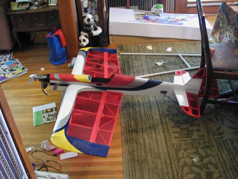

Had one and flew the heck out of it.
Its last flight was a week or so ago when I was bringing down for it last landing.
Touched down on the ground and the gear just gave away from the fuselage and the plane cartwheeled over.
The firewall came out.
Was planning on retireing the airplane as I'm getting a used Sig Mayhem from a buddy to fly around.
You are right this is a very fun plane to fly and had a few issues with the build but solved them pretty easily.
The battery went under the fuel tank and the receiver was put into the cockpit area.
I ended up putting alot of weight on the nose to balance it out and that was with a saito 100 on the nose.
Here are a couple of pictures of mine.

Sorry to hear you wacked your plane that sucks.And your right about a few problem like weight issues i put the os 70 4 stroke on it and still had to add alot of weight.Also there is no room on the inside of this plane i stuck my batterie above the fuel tank.And had to cut wood away for the receiver in the back of fuel tank.But over all i built it in 2-3 days even with work. So it was the most easiest plane iever built.

Hey i checked out your majic.Baeutiful job man.Looks proffesh.I did not put the stickers on mine though.Do you still have it?
