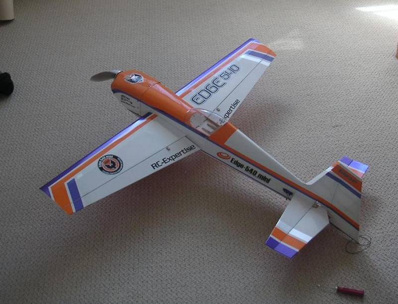

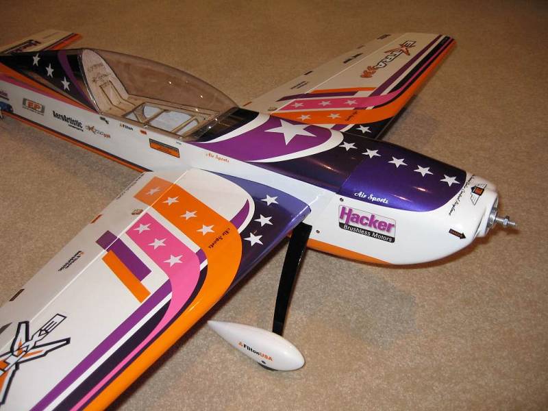

Just finsihed off my Mini Edge, and the Extra is almost complete.
Edge:
HS55s
Axi 2808/24
Jeti 30amp
R700 rx.
1700mah 11.1v
Extra:
Futaba 3050s
Hitec 5245MGs
Axi 4130/16
Jeti 70amp Opto
R700 RX
2 x 3400 11.1v (22.2v)
The edge is RTF, and the extra needs about 1 hour more work to finish it off. Both models should be flown within the week.

Keep us posted on your flight results.
You have two very nice planes.
I am also interested to see what kind of flight time you will get on the Edge.

Mark,
The spinngr is the 45mm irvine one (i think, its the smallest in the range). got it from als, its a bit big for the
edge, but only by a few mm, its looks good in the end.

Volkan,
Enjoy these planes, I have both and think they're great fliers. my extra is wet, though (saito 91). You may want to reinforce the landing gear mount on the edge, some guys reported failures. I used 1/8 x 3/4 lite ply on each side from the firewall to the first stringer. Not much weight, but has held up well. Good luck! T.
