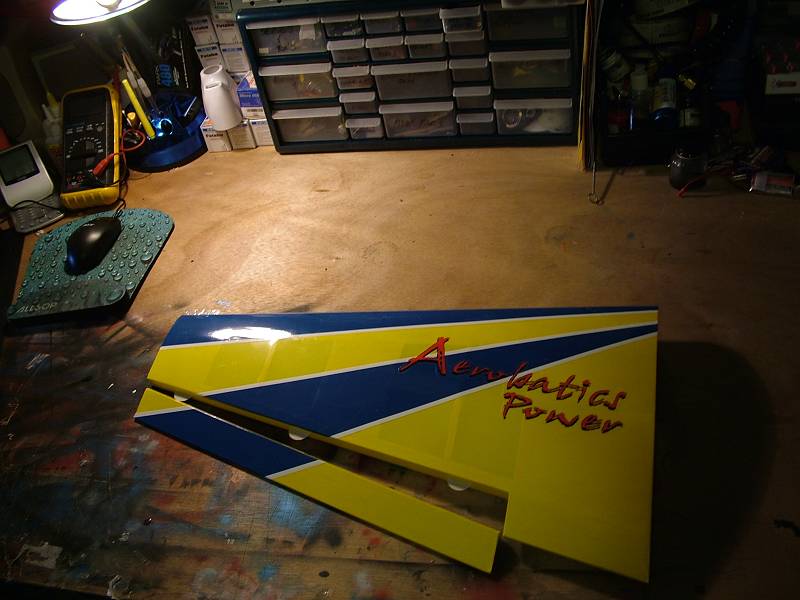

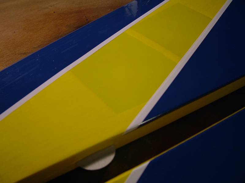

Step 1 - Hinging the ailerons.
Pretty straight forward task.. plain CA hinges. No mystery here. Easy to do.

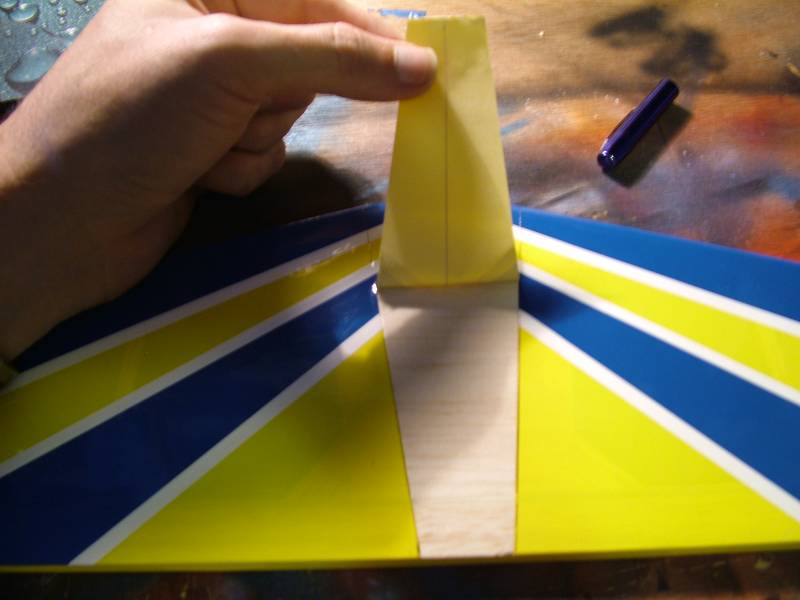

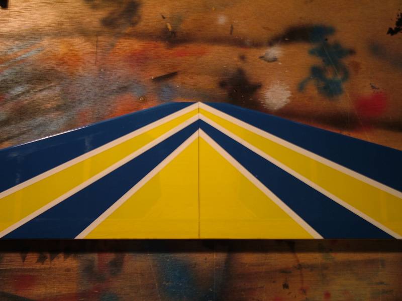

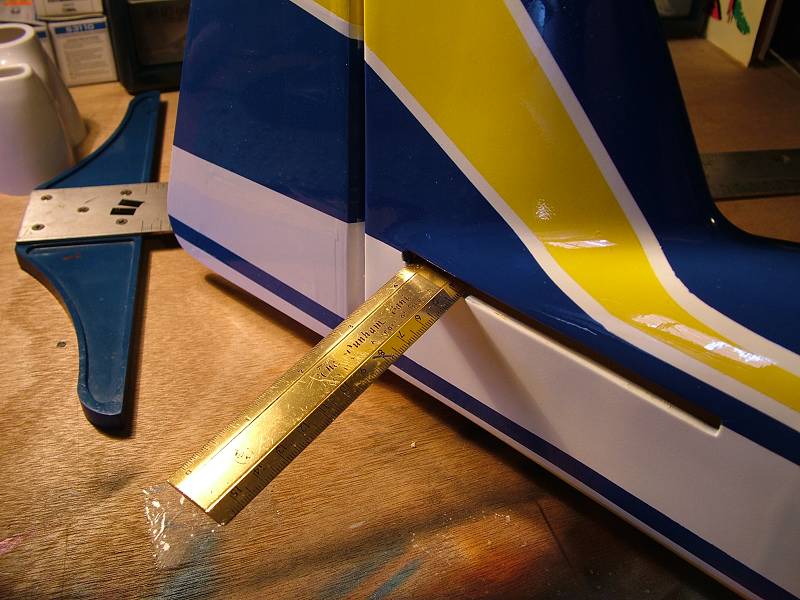

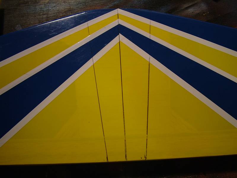

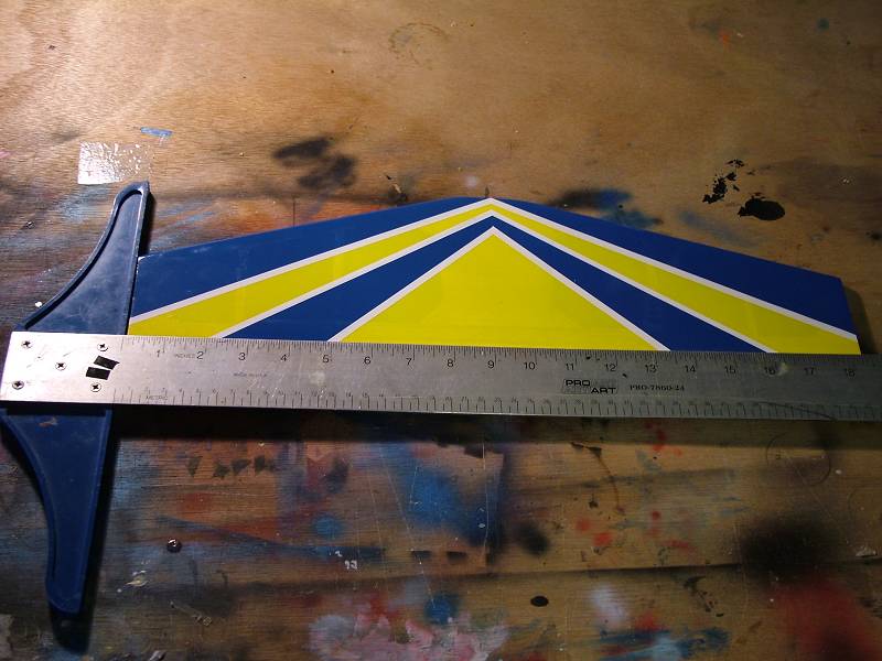

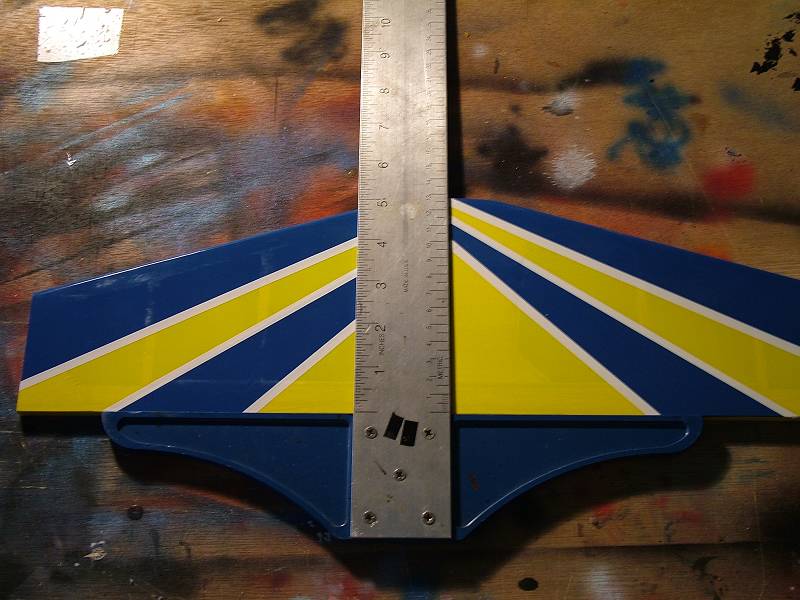

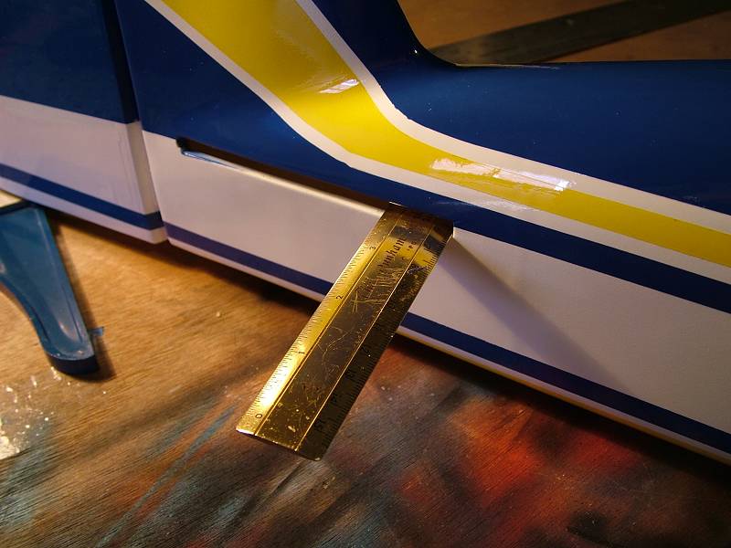

Step 2 - Installing the elevator.
The slot is already cut into the fiberglass fuselage for the elevator. All you have to do is remove a little covering, line everything up and epoxy in place.
First measure the entire elevator. Find center, and using a t-square, draw a line down the center of the elevator.
Now measure the front and back of the fuselage slot.
Transfer it over to the elevator, and cut away the covering. Really easy, and if done correctly, the covering will match up exactly to the plane.
Now the last pic is a dry fit. Not applying epoxy just yet.

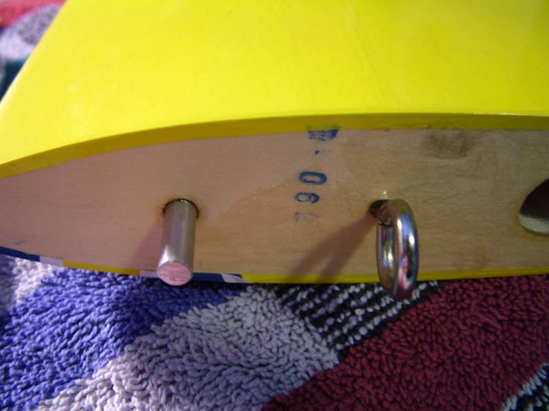

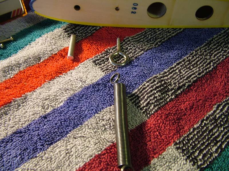

Step 3 - Installing the wings

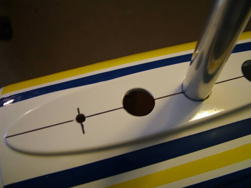

In reality, there isnt much to do here, but it is a critical part. The holes for the anti rotation/incidence pins are already drilled in the wings, but not in the fuselage. The fuselage has little molded divots where the holes are "supposed" to be drilled. DONT USE THEM!!!! They are close, but not dead on accurate. I found them to be up to 1/16" off. If you use them, most likely you will end up with one wing at a different angle...which equals....rolling tendancy and never tracks right. Since you cant re-drill the holes in a fiberglass fuselage...you'd better get it right the first time.
Here is how I did it.
First install the pins into the wings. Make sure when you epoxy them into place that they are EXACTLY 90 degrees to the wing root. You may have to trim the holes to get the pin to set just right.

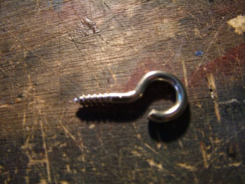

Next take the little eye screws and using a dremel, cut them so that it forms a hook. If you dont do this, you cant get the spring on later.
Epoxy EVERYTHING in place...including the eye screws.
Now measure and draw a line directly down the exact center of the wing root on the fuselage. Slide the wing tube into the fuselage, and slide the wing onto the tube. Line everything up, and mark the fuselage where the pins are. Then drill the holes in the fuselage. Check, double check, and triple check everything...if you screw this up...your hosed.
Once everything is drilled out, then attach the wings, and install the spring. Check everything for alignment.

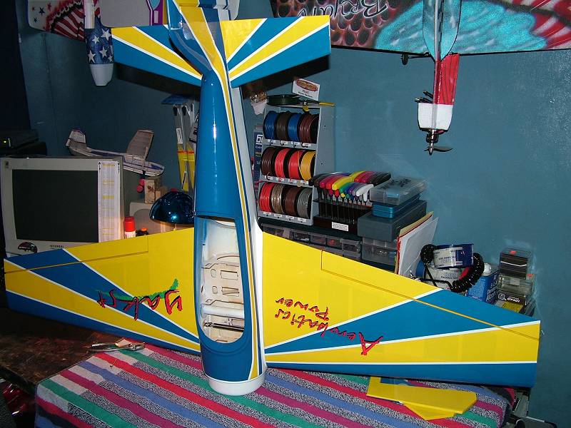

Here's the wings installed.

I would not use the spring...metal to metal causes radio glitch....could use rubber bands. Capt,n
