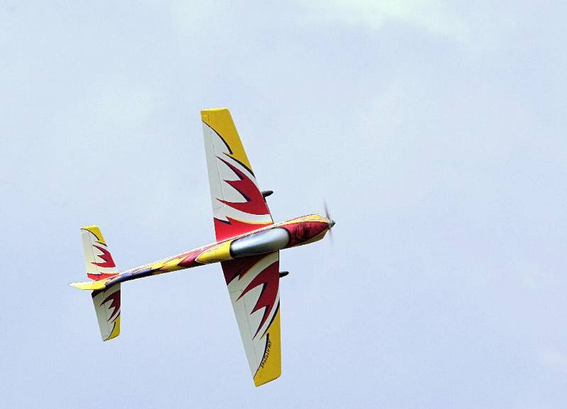

Mike, is that a Rhapsody, they are awesome models and in the category of little mixing required. By the way im selling mine
